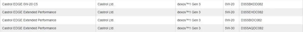

So far, none of the additive pkgs posted in this thread are licensed for Dexos 1 Gen 3, which is an approval that EP 0W20. Is it possible that Castrol had something made exclusively for them by Infineum?
My thought was that the additive package that Castrol is using for the EP line-up could already pass the D1G3 requirements without any problem. It is the same additive package that Castrol uses for "Castrol EDGE C5 0W-20" sold in Europe. In fact, I believe that EDGE EP 0W-20 and C5 0W-20 are the exact same product. For the US market, Castrol extended the lineup with 5W-20 and 5W-30, the only difference being the viscosity. Pretty clever.
The lubricants below are all D1G3 licensed:
https://www.gmdexos.com/brands/dexos1_3/index.html

I don't think it works that way? I thought the usual approach was for the additive supplier to supply an additive pack that is stated to pass testing for a given specification if the blender abides by a certain "recipe." This way it saves on significant costs for the blender.
@Foxtrot08 - how does this typically work?

Castrol EDGE EP 5W-20 and Castrol EDGE EP 5W-30 are only available in the US market and probably Canada. These two don't go out of their way to list any approvals, except for 5W-20 claiming ACEA C5, and 5W-30 claiming ACEA C2.

That's the way it is for smaller blenders, they buy pre-approved additive packages and as long as they abide by the rules for what they can be blended with, will result in an approved product IIRC.
I think there's a rather significant departure for that with the juggernauts like Mobil, Shell and BP who likely have very customized DI packages developed in a collaborative manner with a tremendous amount of their own input, as they already know, or have a very good idea, as to how they want to blend the product in terms of base oils, VII selection...etc. Which may look nothing like what is produced by Warren, Ashland, or even their own commodity/reseller market products (Motomaster, AutoZone...etc).
Of course it also begs mention that not all smaller blenders package and sell a commodity DI package in a pre-approved base oil blend. Some of these products may start off with one of those additive packages, targeted at a given slate of approvals, and then depart wildly in terms of base oil selection and final additive composition.

I can’t go too far into this without giving away confidential information.
However as Overkill said, Castrol could have a proprietary additive package developed for their different blends - depending on base oils used, tests licensed for, etc. They would go to infinium/Afton/Lubrizol/whomever and have an addpack tweaked to what they want to market. Then blended for them by a toll blender and packager.
Or
They could simply coat tail on another pre-packaged additive by who they’re using as a toll blender and market it accordingly. Much like what you’re referring to.
It can certainly work both ways. I know majors that do it both ways depending on product line up and where they want to focus their money. Developing a specialized addpack and getting it fully licensed may be cost prohibitive for some brands - even majors. Volume is key. If you’re Mobil - it’s extremely easy to move volume between the retail and wholesale side.
If you’re Kendall, it’s not easy to move volume. Which is one of the reasons why Kendall moved away from the liquid titanium addpack in their changeover for SP/GF6. It allowed them to streamline their offerings.
