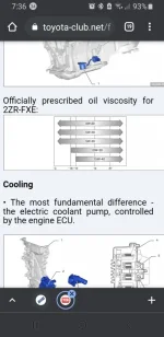

Looks like 5w30 may be ok after all. I live in CT, very rarely goes below 0 degrees F here
