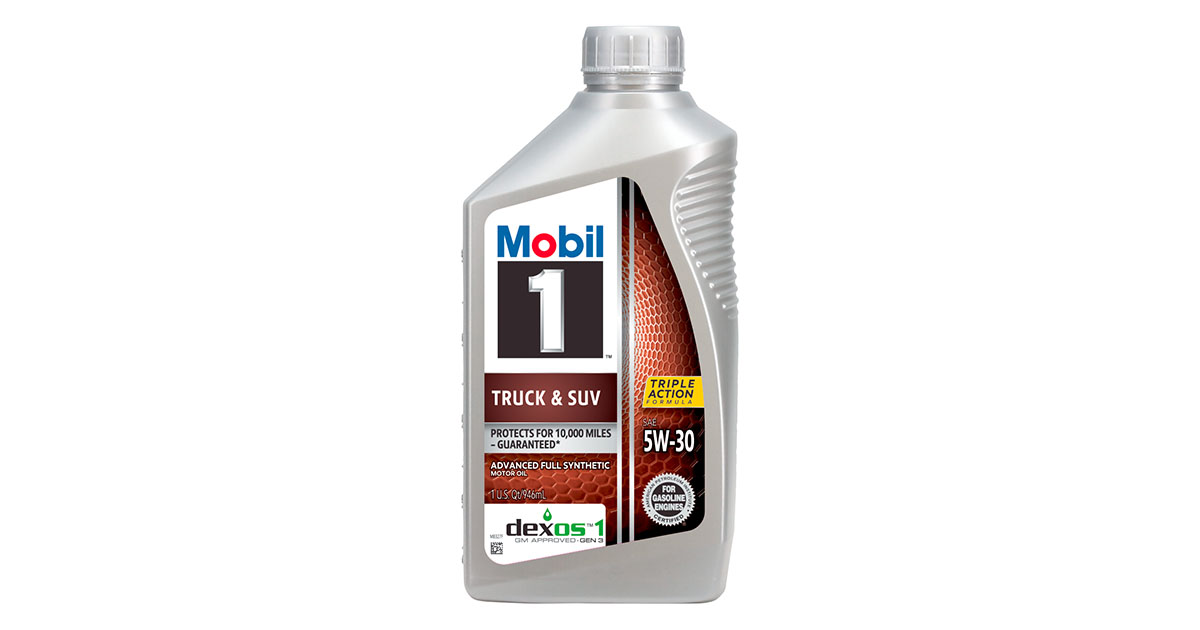

Mobil 1 Truck & SUV oil formula
Probably same formula, just used getting the chrysler certification as an excuse to change up the label. Currently running this in my 5.7 hemi and it’s completely eliminated the famous hemi start up tick.
Noticed immediately my 5.3 V8 is a lot quieter after I started using it.
I doubt it... it may have "masked" the sound, but oil cannot eliminate a materials, heat treatment, or engineering problem. But, convince yourselves what you like. Confirmation bias is the hardest "data" to disprove...

Different formulation, it was out years ago and then taken off the shelves and brought back again.
Mobil 1 Truck & SUV in 5w-30 grade latest formulation appears to be much different than other Mobil 1 variants: it has a very high flashpoint, 261 degrees C.

OK, found the YouTube videos purporting to show recent Blackstone VOAs for Mobil 1 Truck & SUV 5w-30 vs. Mobil 1 EP 5w-30. (Both are marketed as "Triple Action", whatever that means).
The YT poster is an admitted M1 critic. His math is somewhat off in claiming that the add packs are virtually the same: in fact, moly, Ca, Mg, and P are all about 10-15% higher in the T/SUV version. The Blackstone analysis flashpoint for the T/SUV has a value of 410 dF, which equates to 210 degrees C. That's far below the spec sheet value of 261 dC, so either BS, Mobil, or the YT poster has some 'splainin to do. BS has a kV100 value of 9.5 for the T/SUV oil, barely in range and significantly below Mobil spec of 10.00; possibly within Mobil's internal allowable limits but I doubt it.
I wonder if the T/SUV sample submitted was in fact the latest version of the oil.
