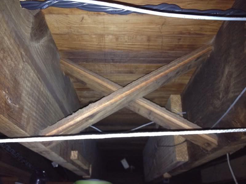

Those 2x2s in an x shape are called bridging. They are there to help eliminate deflection. If you can access the floor from the basement put a bead of glue on a 2x4. Push it up tight to the floor and nail them.

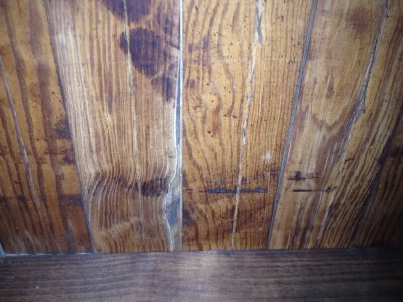

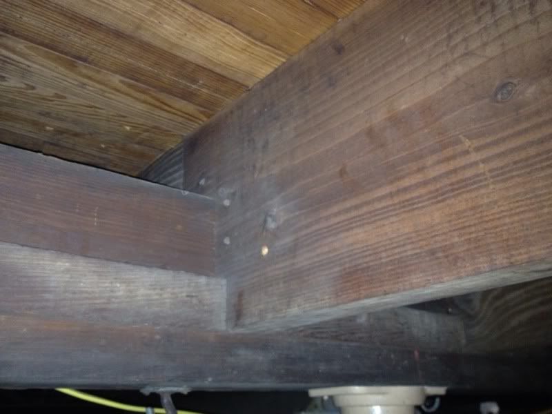

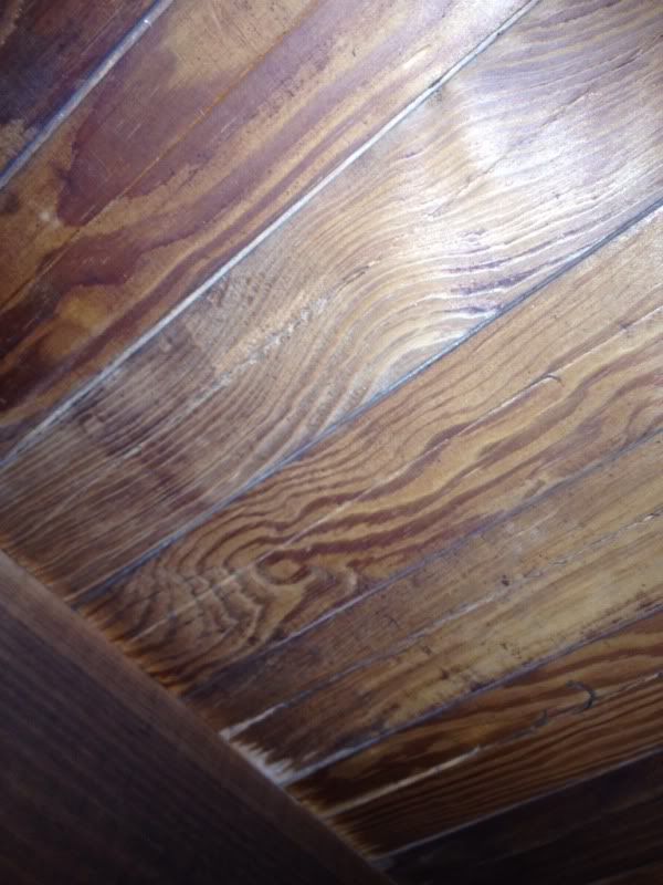

I am a custom home builder. I can give you a fix but I need pics. Pm me if you want a professional to instruct you on a fix for this issue
A few images I took:
Main "beam":
The "X's":
This is the underside of the hardwood floor in our home. There is no subfloor:
I was giving you different examples to repair a sagging floor. 1/2" to an inch is not as much as you think. Most floors have sagged more than an inch over the years. Using an adjustable lolly-column is another example
But now I have seen pics. Wood looks good and yes the x braces pictured are doing basically nothing for you support wise. knock them out, replace with 2X12's as discussed. Will work out great. depending on how much expansion/contraction you have, be careful locking that hardwood in place.

Sure its called a "Flitch Plate". There are some pics on line where you can see it in use bolted to the outside of a beam. But after looking at your pics I don't see the need, the beams look great. As stated above I would substitute the x braces for solid braces, that will give you more support under the floor and IMO better deflection. Knocking the crosses out and adding solid braces will not effect structure while doing it, what I meant. Or just leave them and add the solid crosses. All depends where the squeak is. I searched and found This Article that better describes (in your case just the solid brace not the sister). But first I'd be off to Lowes for a bracket like this and some small wood screws. Just draw the floor tight to the beam, should do it.

I've got nothing to add but details like this are why old houses are so interesting! No khrappy joist hangers needed and nice tight cuts.
