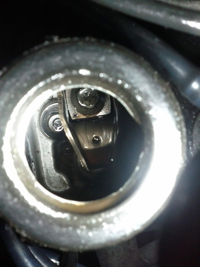

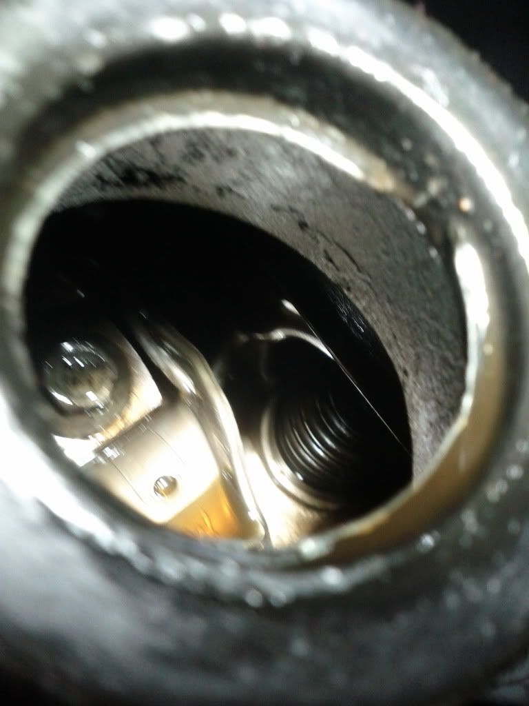

Here are pics.

Everything looks good. A little bit of build up on filler neck and on hold downs.

Did they see it? Or did they comment based on you telling them how many miles and that it had an unknown history? Looks good to me.
but if money is no problem, theres no reason not to do what your friends said. I have done similar OCIs when buying a used car with an unknown history.

PYB is an oil, a very good oil. It is not an engine cleaner or flush. All 1000 mile OCI is going to do is waste oil. Leave it in at least 3000 miles, then dump it, at least that way you'll give the oil a chance to do something. Or add Kreen to the mix and run that a 1000 miles and dump it, at least then I'd be pretty sure some cleaning was done. JMO

If that's sludge, many of us would wish our cars had more of it.
That valve train looks really clean.
The previous owner apparently took the car to the quick lube on a regular basis.
Man whoever told the previous owners that it was sludged and needed to be flushed was just trying to sucker them/upsell them on something they totally didn`t need. That engine is spotless!
Looks clean to me, definitely not a sludge engine. Half a qt of MMO in the oil may get rid of the lifter tick and clean any stray deposits.
Just for good measure I'd pull one or both of the valve covers off. I've seen engines on used cars that looked like that through the fill hole. People had cleaned that one area up before they sold the car, but the rest of the inside was horrible with sludge.
In the pics I see some stuff that makes me think of the above situation.
In the first pic: Look whats caked on the inside rim and tube of the fill tube itself.
In the second pic: The heal has black spots on it and on the left edge you can see black particles and such.
It just looks like the area that you can see may have been cleaned before sale.
That's a clean looking engine...no need for a flush...

Looks good for a 3.8L. Be sure to use Motorcraft filters. For some reason, I've always had the best performance and least lifter noise with Motorcraft parts.
As a side note, keep the cooling system flushed and in good condition. The 3.8L has a history of failed head gaskets if the oil and cooling systems aren't maintained properly. Overheating often results in blown head gaskets on those.
