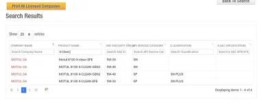

Good point, I checked the API directory and Redline isn't listed. Finding oil is becoming extremely frustrating. The weirdest part is X-Clean EFE being listed as both SP and SN, like *** is that supposed to mean.

What's considered low enough calcium to prevent LSPI, like the X-Clean EFE has around 1800 in a VOA and is SN but the Xcess gen 2 has a lot more and is now an SP.
**** is confusing, especially when I come across this (attachment)
X-clean and EFE are C oils.
Dont compare calcium levels with A3/B4 regarding LSPI.
SAPS takes priority in that case I believe.
Or just dont mash the throttle pedal at 10mph in 3rd gear ffs.
