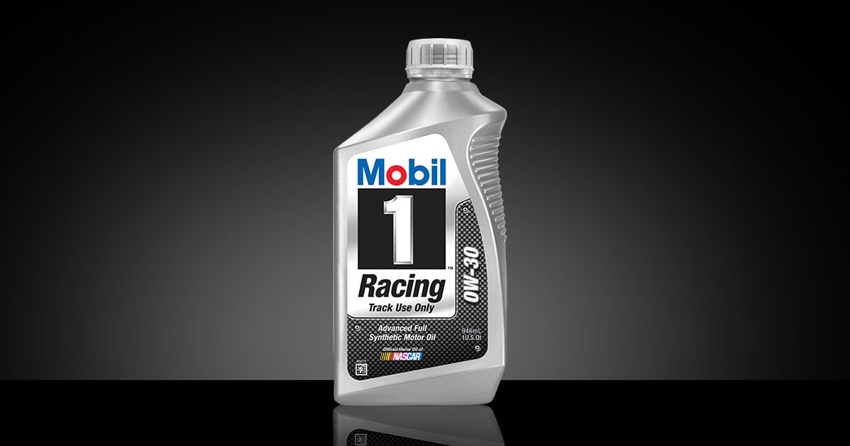

For your stash of oil, all you need is a pint or quart of race oil, per sump to spike the AW additives. This way, you can use all your oil that you have. Otherwise, you have to ship all that stash of new oil to me and I will 'recycle' it for you. Use the 40 or 50 grade equivalent if you want to spike your viscosity too. Unless you use aftermarket PSI/temp gauges, I probably wouldn't go super power degrading overly thick on the oil.
https://www.mobil.com/en/lubricants/for-personal-vehicles/our-products/products/mobil-1-racing-0w-30
https://www.amsoil.com/p/z-rod-10w-30-synthetic-motor-oil-zrt/
https://www.royalpurple.com/product/xpr-extreme-performance-racing-oil/
https://www.redlineoil.com/30wt-race-oil-10w30
https://torcousa.com/collections/torco-professional-series/products/sr-5r-synthetic-racing-oil
