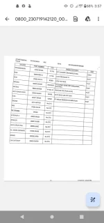

I'm mentally exhausted at this point and I don't know what or whom to believe. Just got more news from Nissan. So despite the rear differential being the actual problem, apparently it actually has had CVT judder for a couple months now. But the judder is so minor that I haven't even noticed it. Not going to bother replacing the transmission, just doing the rear differential and whenever the CVT blows apart completely then I'll address it.
