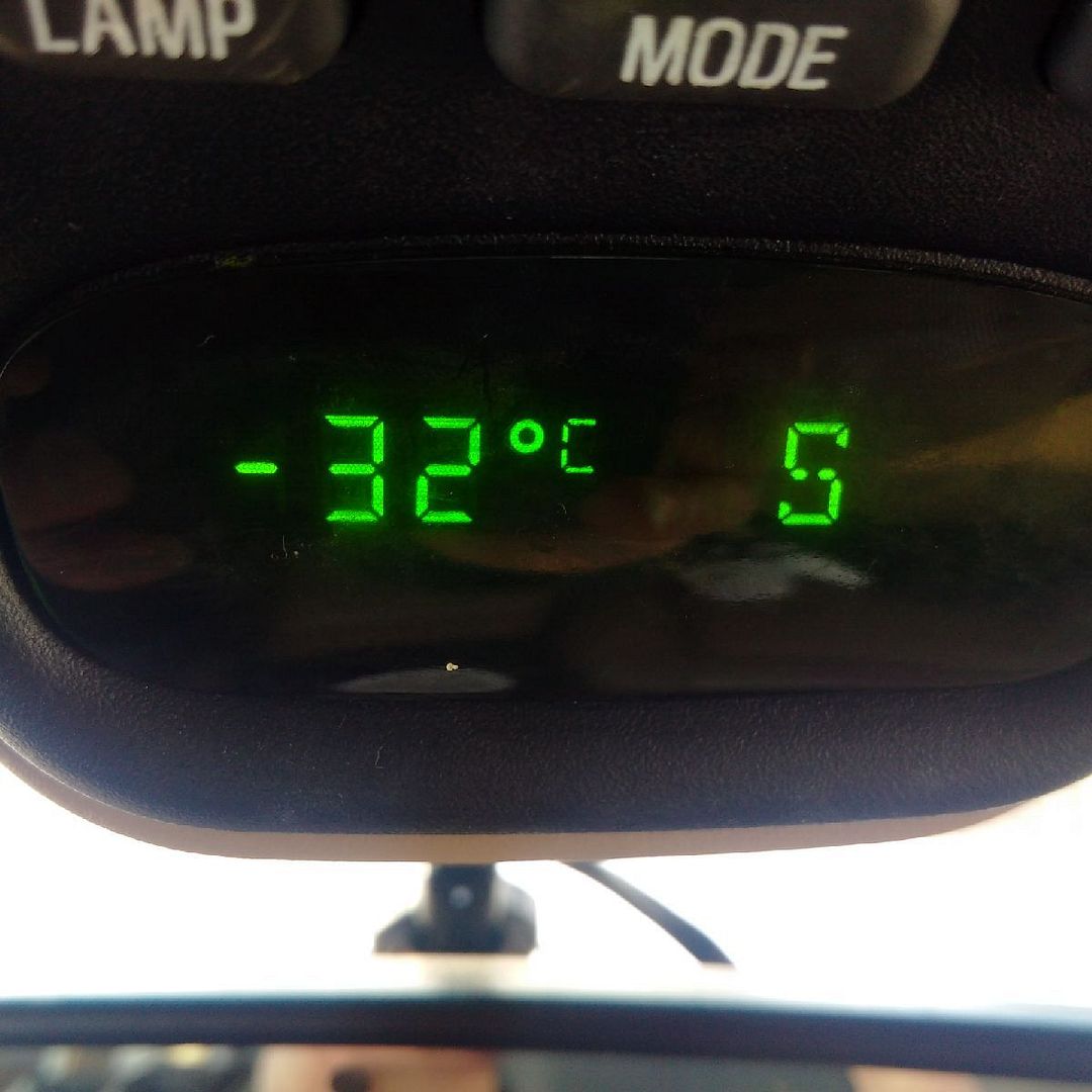

I saw this more than once last winter...this was taken after the sun had been out for a few hours...My 16 year old Explorer with 290K started up, but made some nasty noises till the chain tensioners took pressure
