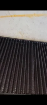

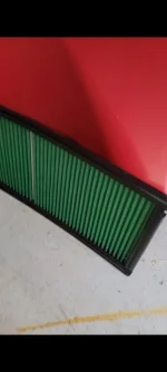

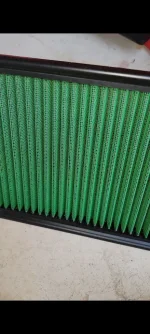

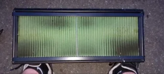

This is a green filter. I cleaned and re-oiled with k&n black oil so that it wasn't so **** green anymore lol. This is an over the radiator intake so the filter is visible as soon as you open the hood. The last pic is the back of it. The bqck has black mesh, so that's straight black. The front has green wire mesh so that is the only green left. The cotton under it is now dyed black.
