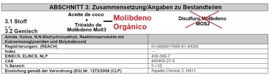

Good morning, I write from Spain.
A few weeks ago I had the Liqui Moly Ceratec analyzed and here I leave the results.
Apparently currently (I do not know in the past) it does not use MOS2 but organic molybdenum.
Everything indicates that the base used, depending on the spectroscopy and the flash and freezing points, is HC base
