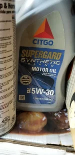

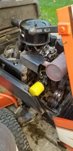

I think the idea of storage w clean oil is a good one. I store my summer only bmw with new oil just before storage time. Got gas and added sta bil and changed oil two days ago.
I think once a year oil changes on most lawn and garden stuff is plenty of care. If your a professional then change oil and hydro fluid several times a year.
