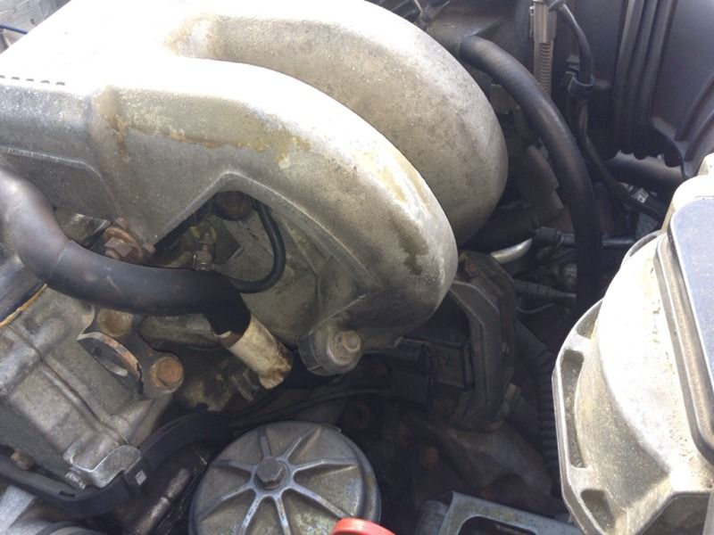

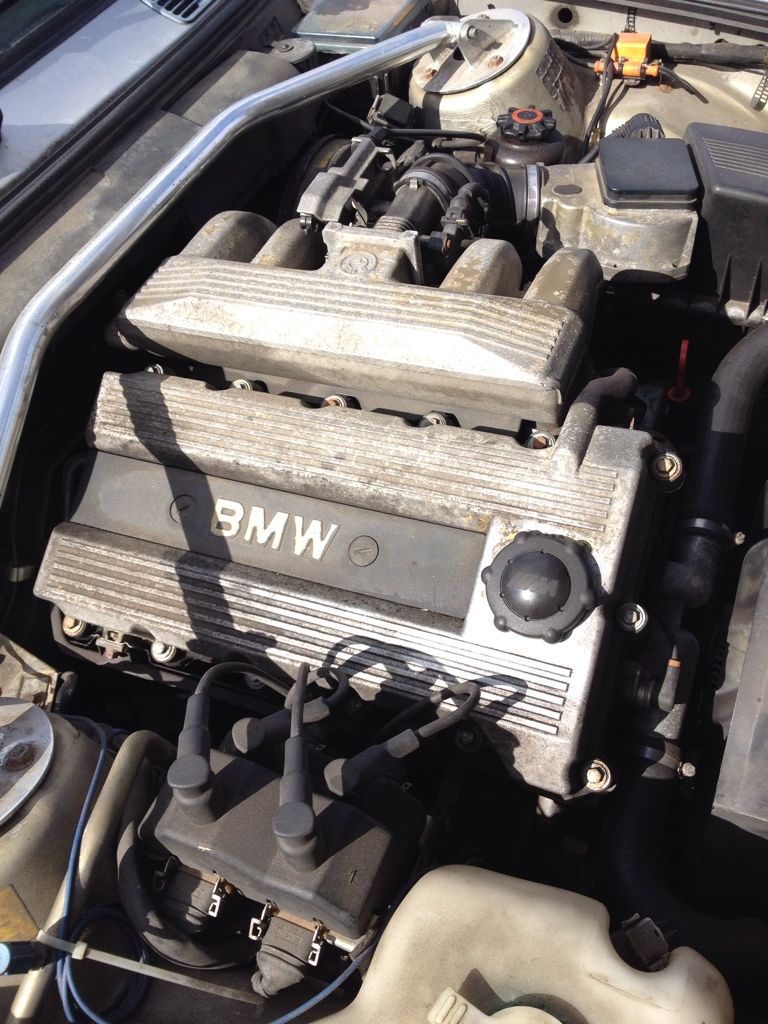

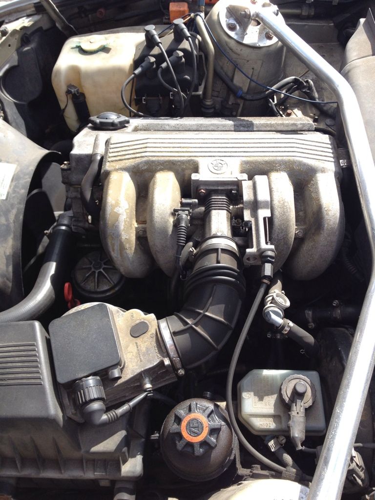

They don't normally have the PCV (none of mine do) but they do have the oil separator at least. Was curious if yours did. Do you have any pictures of the engine, or could you take some?
The reason I ask is that if you DO have it, and it is plugged, you will get high RPM oil consumption.

No separator. There is a network of breather tubes under the intake, and a breather that goes straight to the intake trunk near the tb.
OK, so the large tube coming off the valve cover, it just goes back into the intake manifold?
That's normally what goes to the separator if so equipped.
I would check that hose to make sure it hasn't collapsed and can properly vent, as that could very well be your issue.

It's real funky. That one on the top goes into a bunch of others under the intake, and come out on the other side with one directly into the TB, and a big one into the trunk.
The car is real sensitive to vacuum. Pulling the hose from the vc will cause a near stall unless the hose is plugged. Disconnecting the other end at the intake trunk will set a cel.
The vc has a port on the opposite side that is connected to the ICV.
The M42 is a bit of a screwy design with the breathers.
P.S. pulled the big hose from the vc, plugged it, and watched. The engine has next to no blowby. And it's at full temp.

Well, that's good to hear! How much oil residue is in that hose? What about the one at the other end of the VC?

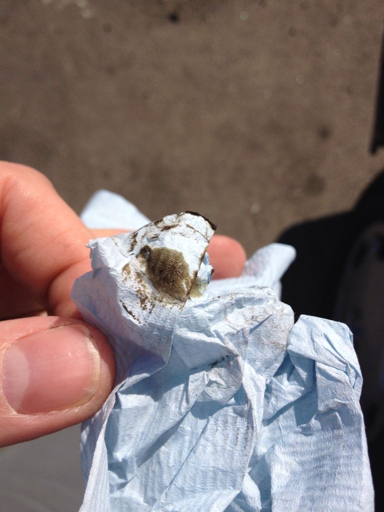

There is some dampness there. Not oil per se, more like the wet mix of garbage from a catch can. Will take more pics.
SI this is after 100 interstate miles today. While there is residue in the pipe and I know there is some in the throttlebody as well it is in no way excessive.
This was the drip that you saw hanging inside the hole on the valve cover where the hose attaches.
