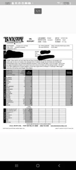

ok - you run M1 EP for 20 months and 20,000 miles and let's see how it does.
I have a UOA of the mobil EP 5W-20 at 15k and about 7 months in a 5.7 hemi about 13k of it pulling about a 4k lb trailer and about 1k of it pulling roughly 8k
