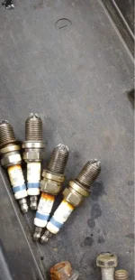

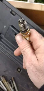

I believe he had the plugs for a vehicle he sold. He offered them to me and a Toyota OEM valve cover gasket. The plugs that were in car when I changed them were NOT even close to correct ones. Here are those
That still does not rule out them being online bought fakes.
It wouldnt hurt to pull the misfiring one and give it a visual inspection. But I also doubt its the plugs.
200k a coil or wire seems more likely.
I have been burned 3 or 4 times on fake NGK plugs from Amazon. Pull one or two and look at the electrode. The fakes I got had worn, rounded tips in less than 40K.
