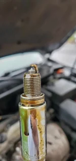

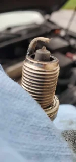

Then none of them look right for only 1,200 miles.
What is the recommended mileage interval for a spark plug change on your Camry and what did the old ones look like?
The change interval for iridium spark plugs is specified from 60,000 to 150,000 miles.
Old plugs were Denso. The NGK ones are already burnt. Which is kinda weird.
Which is a clue …………
Others more knowledgeable may chime in as to why that would be with only 1,200 miles on those plugs. And whether a single bad coil could cause all four plugs to look like that.
Somehow, I doubt it.

I replaced the Denso plugs with NGK plugs 1200 miles ago. Just ordered 1 denso coil to replace the messed up on. I'll see if that makes a difference

Could be a fuel air ratio causing the plugs to be "burnt" already
Why is the socket and spark plug threads in the 1st photo covered with oil? Was that the old Denso plug that was previously replaced or a new NGK plug that you just removed today? If the oil is leaking into the spark plug tube, it will cause the misfire by shorting the coil spark to ground.
Yep. The seals are shot.
Those were the old Denso plugs that I replaced.
