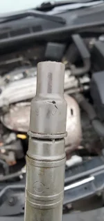

This might be the culprit. Found this crack on coil pack #1

That little "ding" can cause a misfire? That's wild
That’s a crack near the high voltage area. Which is surrounded by all sorts of well-grounded metal (the spark plug tube). Under high throttle, the voltage required to jump the spark gap goes quite high. Under low load, less voltage is required, thus you could have a situation where it runs fine around town, misses on hills on the highway.
Once it starts arcing, it can carbon track and make future arcs easier.

You might be right. When I was driving, my brother-in-law jokingly said "floor the car" I floored it a little and the RPMs rose from 3000~ up to like 4500~ and that's when the whole car started to shake and the CEL came on.
The car started slowing down on its own. Hence why I thought the trans went out.
