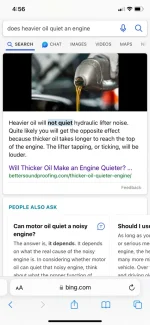

I know one thing this site if full of threads reworded 1001 ways about oils to thin who wants it thicker. Well since I don’t understand physics I turned to my search engine here’s what I’m told.
Ah yes, bettersoundproofing.com has always been a trusted source when it comes to tribology.
Not a personal attack, but evidence that you can't just Google something and expect accuracy.
