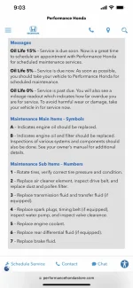

The maintenance minder does have a code on it that signifies when the CVT fluid needs done, but I can't recall offhand what number that is.
