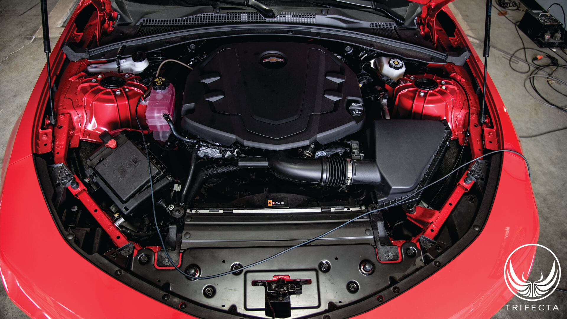

LGZ/LGX are basically the same. Yeah it was a significant upgrade.
https://www.trifectaperformance.com...ation-of-v6s-from-gm-rpo-lgw-lgx-and-lgz-r75/
"The LGX and LGZ engines are basically identical, with the exception that the LGX was designed with car applications in mind and the LGZ is designed for the 2017+ mid size truck (Chevrolet Colorado and GMC Canyon)."
