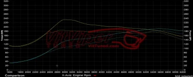

Ah. Even then, I doubt that it very low load it would make a difference.
I mean, here are dyno charts from ktuner (which I run on all my turbo honda's), the dotted line is factory tune, and its making 40hp at 2000rpm if he is cruising on the highway, he is only putting down 120lbft of torque and that would only happen at WOT on a dyno, so probably even less, just enough to keep the car running.
