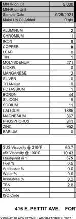

Here’s a 5K sample of 5qts of MC syn blend and 2qrts of redline 5W-30 that I used on my truck
PPM were 8 on iron and 8 on copper
How’s that compare with HPL ????
Thanks for your info 👍
OP has nearly 2x the iron per 1000 miles but this is tough to compare as both engines will have their own normal/baseline.
