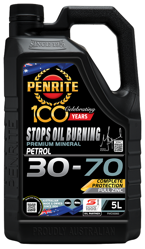

Originally Posted By: Shannow
Steam turbine...OEM specs ISO32 and ISO 46...runs ISO 32.
Isn't that the equivalent of SAE 0W-8? It's nine viscosity grades thinner than the standard-Aussie-issue SAE 30-70 you run in your cars. It must be giving you nightmares.
