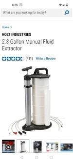

Are you talking something similar to this?
Yes sir.
I'm pretty sure that version both extracts and dispenses.
The one I have is extract only and I have other units that dispense.
Its old, so likely not the same version, but it deoinst hav the external cylinder.
There is also a version thats pneumatic -so if all your work is in sth shop those are faster and of course no p[umping.
Ive got stuff in sheds, and other garages so the hand pump version works better for me.
