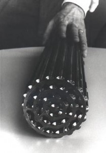

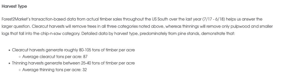

Timber biomass is ~87 tons per acre; 174,000lbs. One 20g CANDU uranium pellet produces the same amount of electricity as 882lbs of coal. There are approximately 23 of these pellets in a lb. Ergo, the electricity yield from one 20g pellet is 12,355,000Btu.

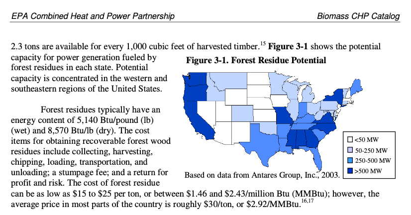

The yield from natural uranium is 284,165,000Btu/lb compared to biomass at 5,140-8,570Btu/lb, making it 33,158x more energy dense than the best timber biomass. So, one acre (174,000lbs) of dry timber biomass can yield 1.49 billion Btu. The same in uranium 49,444.710 billion Btu.
So, it would take 33,158 acres of biomass to yield the same amount of electricity as 174,000lbs of uranium; 4,002,000 20g pellets. Since we know there are 20 pellets per pin in a 37 element bundle, that's 740 pellets per bundle, 5,408 bundles.

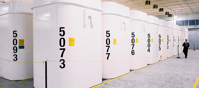

Each used fuel storage cask holds 384 bundles, so the two visible rows here represent 7,680 bundles. So, 14 of these casks is the equivalent to 33,158 acres of biomass. This facility houses 700 containers, the equivalent to 1.65 million acres of biomass; 6,677 square kilometres.
