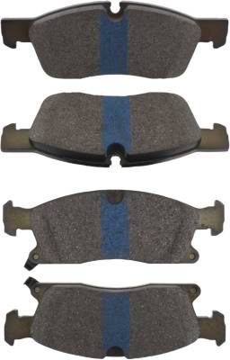

The cheapest pads for the Trackhawk are $45 on Rock Auto.
Outside Rock Auto, there's EBC @EBC Brakes UK
Even the NDX Bluestuff is "only" $200 for the set.
The Ultimax Blackstuff pads show up on Autoanything's site as fitting your Trackhawk, but they're not listed on EBC's site. The lowest pads EBC lists for your car is the Yellowstuff.
