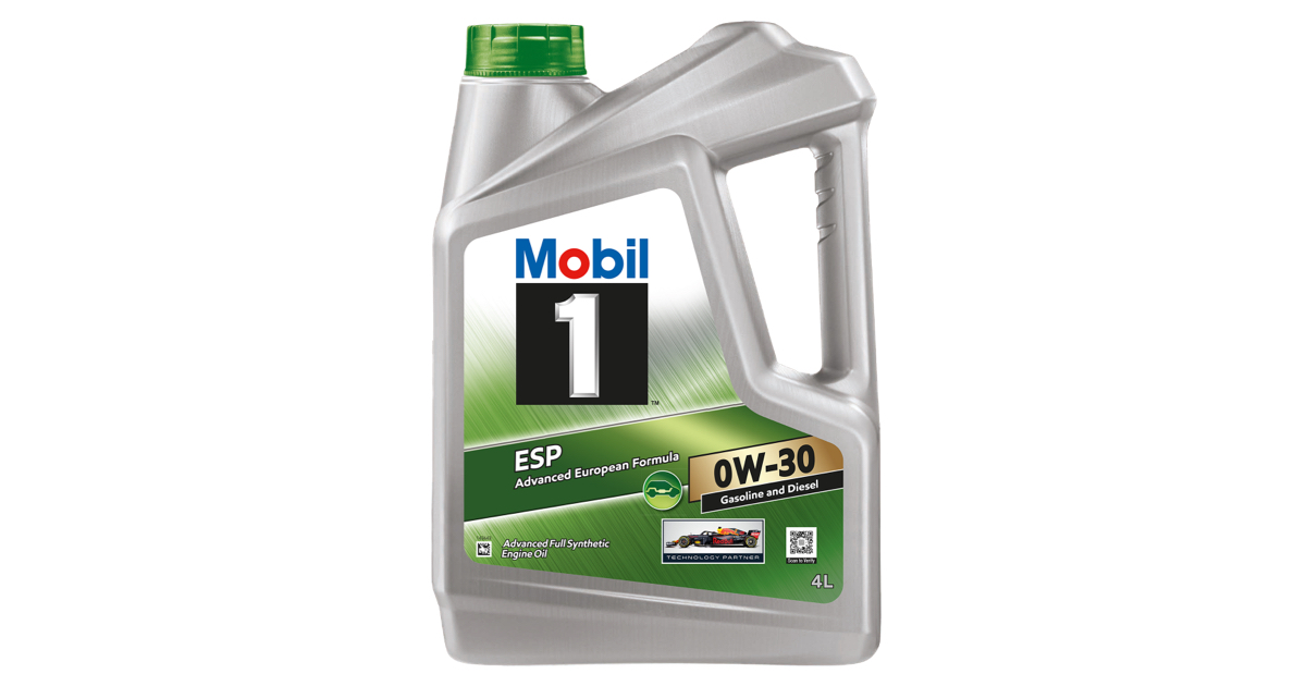

I have 3 jugs of it sitting on my shelf that has an 11/2022 manufacture date and API SP is not listed anywhere on it. None of the documentation that I have seen has API SN, SN+ or SP noted anywhere on it.
Yeah lots of conflicting info, including from Mobile but like I said earlier I'm gonna run it. It's good oil.😎

I wonder why they don't put the SP on the back of the bottle. Not necessary I guess because the oil is geared towards the Euro spec. I would think it wouldn't hurt to put something on there though that says "meets or exceeds API SP.
Sometimes it does appear but IMO consumers of euro oils shop approvals not API so putting API on the label is not a priority.
