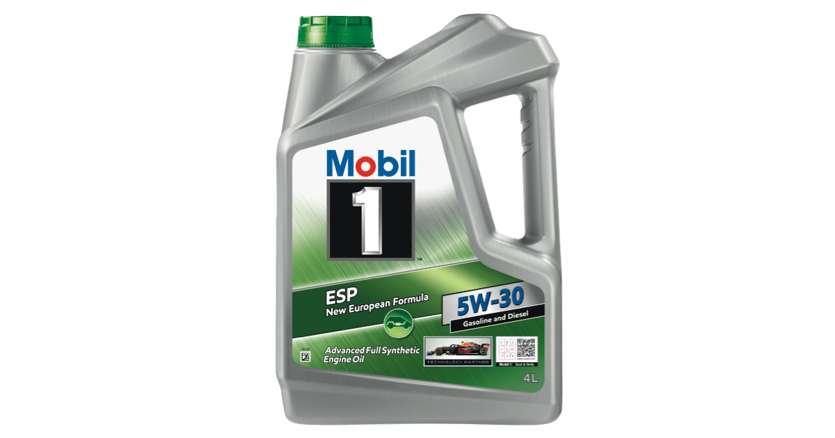

Why not go Mobil 1 ESP 5w30 then? It has even a lower NOACK value. See one of your posts here: https://bobistheoilguy.com/forums/threads/m1-esp-0w-30-vs-5w-30.344955/
I'm actually thinking about going the 5w30 route, as I can get it cheaper locally vs buying Castrol Edge EP 5w30 or 0w20 online.

Sure. Problem is that 5W30 was not at all available at prices that 0W30 was. It just became more available recently. I would use it if I had access for the same price as 0W30. Now that it is, I also started to use it.
I just put it in Tiguan.

What temp is it safe to leave in during winter? I may switch to 0w20 in winter......necessary?

As long as you are not starting it every morning below -20. 5W30 will flow great. I started 5W40 in X5 at -37.
However, if you do short runs and engine is already recommended for 0W20, there is no doubt that oil is more appropriate for extremely cold temperatures.

I am in central WI. Doesn't get what I would consider crazy cold here often, but we are good for a handful or two of days in double digit below 0° temps a winter.
The ESP 5w30 sure does have a handful of approvals! Has a pour point of -48°C = -54°F

Just run that, ESP 0W30 in the winter.
Curious, why not ESP 0w20 in winter?
Probably because the increased HT/HS of the 30-grade (determined by the approvals) is not a bad thing. VW 504 00 approval is a pretty demanding set of requirements. So is 508 00 as far as it goes, but for many of us the extra HT/HS is desirable. Ambient temperature is pretty irrelevant as the winter rating is what matters here for pumpability.
