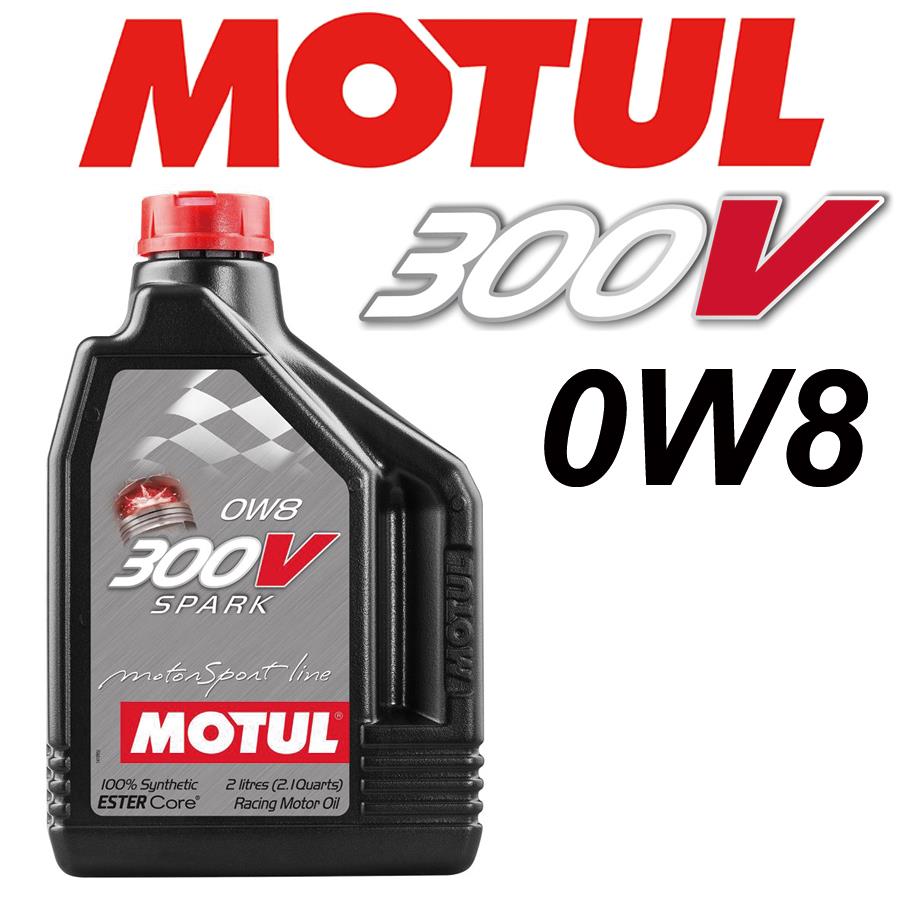

Come on, guys, 0W-20 is hardly thin. SAE 20 viscosity grade is old-school. Who is going to run the really thin stuff, preferably in a BMW?
Road version:
Racing version:
The full thin line:

I would like to see a UOA of that 0w-8 in the Corolla.
Given that there are more than twice as powerful of the 4A-xxx engines out there that still specify 10W-30 like my 4A-LC, I think mine would be OK with as low as 0W-12 but I don't know about 0W-8.
Needless to say the goal of my experiment wasn't to show that 0W-8 is better than 20W-60 but to see how common viscosity grades that have been available for many, many decades (SAE 20 through 50) perform and compare in my engine.
