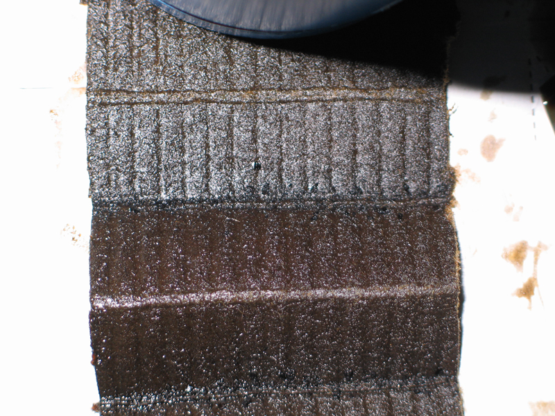

I don't know, but I've had excellent results with the AFE products in our Expedition (zero consumption) and will run the EP going forward in our new RAM, which is the current fill. Do you intend on cutting your filter open? I'd suggest doing so, as that may answer your question.
Is it worth getting my saw dirty? Can you tell if they are the deposits removed by the oil? Do you have pictures?
Sure, it looked like this:
[Linked Image]
[Linked Image]
That does seem like a lot but then again I've never cut open a filter. I always assumed any dirt would be very tiny and sludgy.
Gokhan, I am planning on running the EP on my next change coming up here soon so these assessments are interesting.
Originally Posted by Gokhan
Thanks, that looks like a lot of dirt. Do you regularly look inside your oil filters? Was it different before this OCI?
It's been like 10 years now but IIRC, there was nothing of significance until I started running M1 0w-40 in it? Don't hold me to that though. I don't recall getting much, if anything, in the filters from the Petro-Canada oils, but M1 0w-40 stirred this stuff up and it continued when I switched to the AFE 0w-30, which I ran for several OCI's and this tapered off and stopped after like 5 OCI's.
