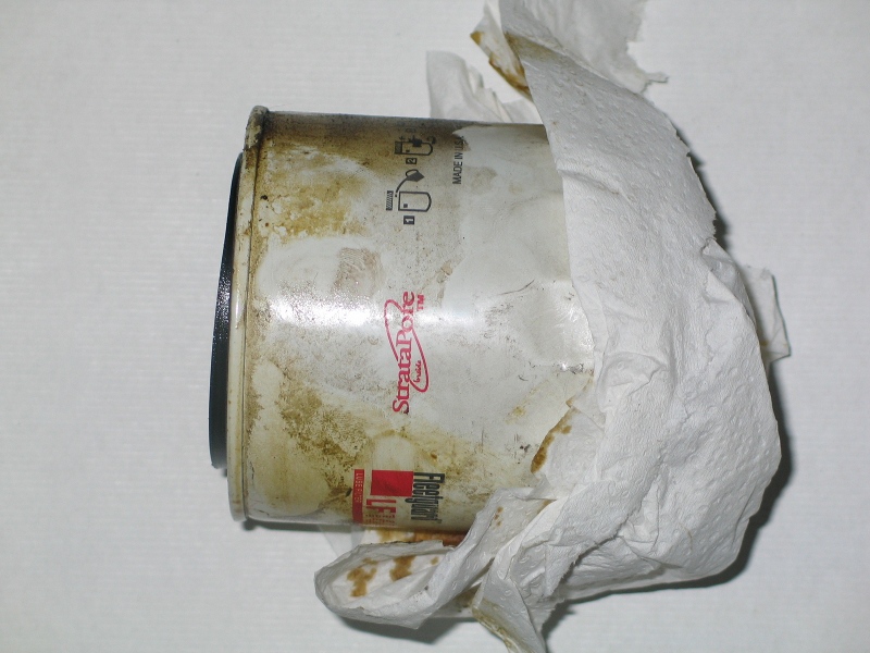

The filter that I took off was a Fleetguard Stratapore. It is the third one on this truck, and the first to make any start-up noise. This is also the truck's first run with M1 0w40. The noise started a couple of weeks ago. Some mornings it does it, others it doesn't. When it DOES do it, it lasts a few minutes before it gradually gets quieter and goes away. For all I know, it could be a sticking chain tensioner...
And when I say minutes, I literally mean it. I start the truck, let it run for about 15 seconds, put it in reverse, back out of the driveway. Hit the turn off of our street, drive a couple blocks up to my son's school, and by the time he's out of the truck and on his way into the school, (this is about 2 minutes time) the noise has gone away.
So, I think I may have found the issue.

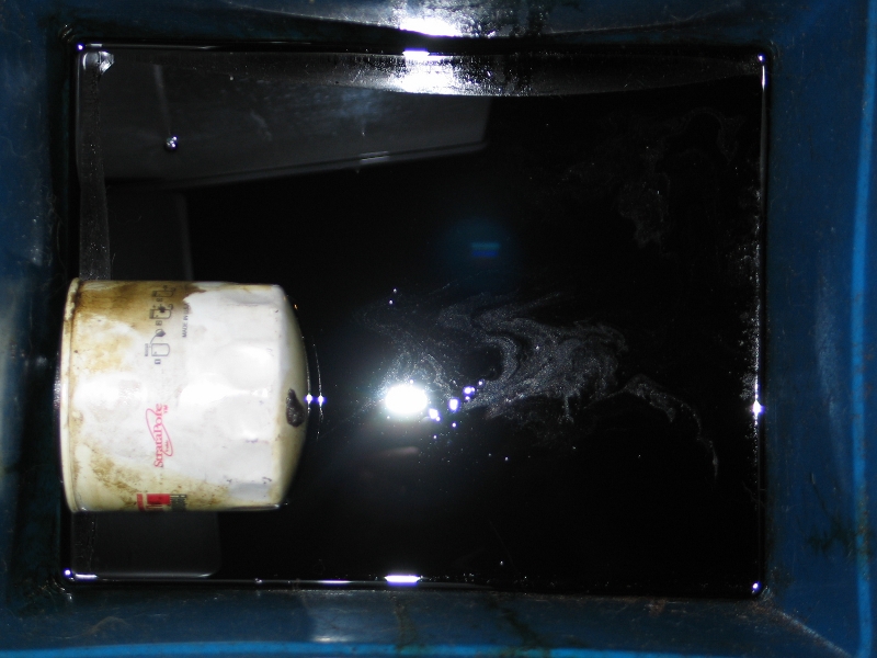

ADBV FAIL.
This bucket was basically empty when I put the filter in it, and this is a few hours later:
I could turn over the filter and watch the rest of the oil dribble out of it!

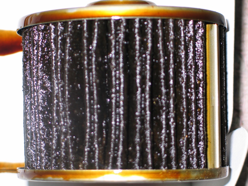

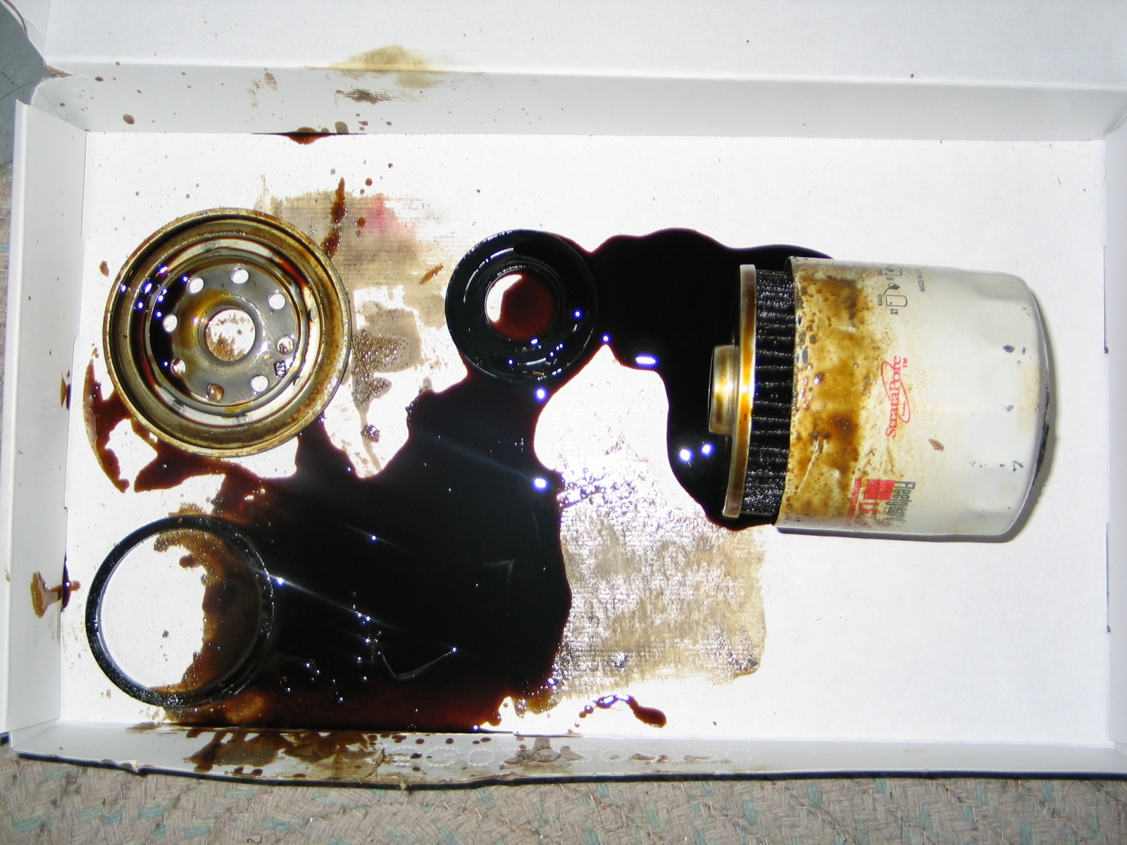

Getting ready to cut:
The cut:
The can: (hey, no grit this time!)
The media:

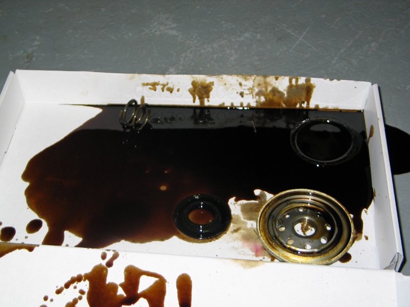

ALL of the oil that came off of the media while it sat AND what came out of the can when I cut it open:
There wasn't a whole lot left in that can...........
