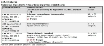

What does it mean when an oil shows a negative VII number, and therefore a higher HTFS vs HTHS? For example if you plug in Ravenol's SFE you get the following:
oildensity15.6KV40KV100VI (info)HTHSA_Harman indexVIIHTFS (BO DV150)D341 aD341 bKV150DV150BO KV40BO KV100
Ravenol SFE 5W-200.842047.20
8.50​
1602.90
1.0057​
-0.29%​
2.97​
8.140​
3.171​
3.735​
2.884​
48.66​
8.76​
Not the lowest Noack of 8.3 though, which I would have expected to be lower if it's base oil viscosity is as high as it appears.
BTW here's a snip from the SDS that I was able to get from them (revised 08/2021). Pretty high in PAO.

You are seeing the limitations of the accuracy of this very interesting but not overly useful exercise unfortunately. I applaud Gokhan for the effort, and for sharing his work with us, but this is very much one man's experiment and there are a massive amount of variables that simply cannot be accounted for here, which is why we see stuff like this.
