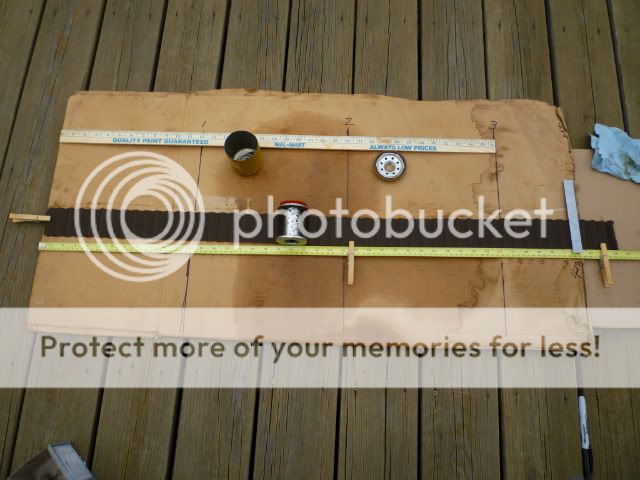

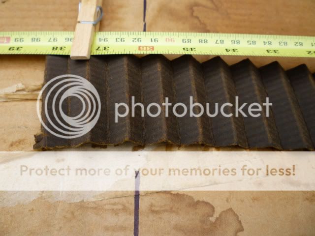

Here's pics of the media at different stages of expansion. Having done this, I'd suggest that barlowc's flattened measure is likely the more accurate measure than using pleat depth and multiplying. Also more work to do.
For reference, the long (oily) cardboard is ~42".
First pic is media just as is/unflattened ~33".
Second pic is stretched to my calculation using pleat depth ~38.25, note too pleats not flat.
Final pics at ~45", media flat(as I could get it). And ~2&3/8 width.
I just counted the pleats in the one that I still had in my basement and came up with the same number as sayjac. So it seems the mystery has been solved and Purolator has not reduced the amount of media they're using in the PL14610.
Kudos to sayjac for cutting the filter open, sharing his findings, and then checking things out when questions came up. It's great to see the PL14610 shining every time that one is cut open. It further confirms what all of us on this site know... the PureONE is probably the best filter available for the money. Although, I still wish Purolator had stuck with the blue paint and not gone to the yellow textured stuff.
I'm still using them, and glad, inspite of the bashing they've taken in some of these threads. Thanks for posting!
sayjac & barlowc - good to see the reason for the difference seen in various measurements of the media area.

IMO, doing the calculation should get you very close to the same answer if pleat and width measurements are done accurately. Cuts down on the effort and mess involved too.
So if you guys measure the pleat depth very carefully, what do you get? I think the estimate was 3/8", but if it's say really 7/16" then it would calculate out to ~105 sq-in.
Example - a 1/16" difference in pleat depth:
3/8" pleat --> (2 x 51) x 3/8 x 2.375 = 90.8 sq-in
7/16 pleat --> (2 x 51) x 7/16 x 2.375 = 106 sq-in

7/16" - 15/32" from the center of a pleat's peak to the center of a peak's valley.

I still had a PL14459 and a PL20195 cut open in the garage from the last oil changes. I also got 7/16" pleat depth on both after some careful measurements with a metal scale with 1/32" graduations. Looks like Purolator uses 7/16" deep pleats on many of their filters.
Dang, this thread/media area measure has been nitpicked to death by one poster to justify the knee jerk implied conclusion, falsely so, of a media reduction in the posted PL14610.
Yes, it's quite possible/likely with 'the media removed' that the pleats depth measure is 7/16" rather the 3/8" measure obtained by using a ruler (Starrett metal in pics) with the media still attached. Seeing as barlowc confirmed it as such using his media, that is the case. That said, I'm not going to now re-measure just to satisfy some need to prove why the media could be flattened to ~45", as I stated/restated it could and have now proven visually.
Curiously though, the 3/8" 'media attached measure' used, is the same measure is the same measure used in this thread, arrived at in the same media on manner, which was fine and unquestioned then. But then, there was no peculiar need to prove another poster(me) wrong, or when that poster, proven correct, the reason for the misjudgement/doubt of the poster's statements.
Bottom line, I don't really care whether the media 3/8", 7/16' deep or 38.25", 45" long. As long as the same method is used so there is some comparable data. So lesson learned here, from now on I'll continue to post dissection pics of filters, but I'm not going to be concerned with posting media area.
