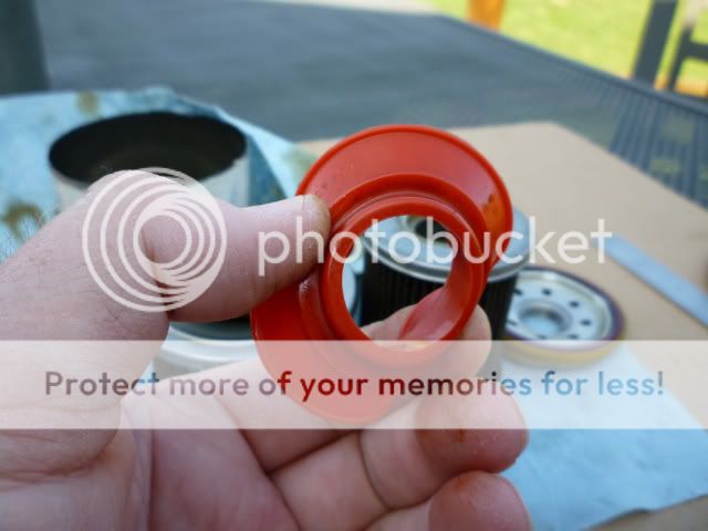

PL14610(R) has 7k/9 months, L14459(L) 5k/5 months.
14610 has 51 pleats, not including metal seam pleat. 14459 has 60 pleats excluding seam. Both filters have 3/8" deep pleats.
The PL14610 is 2&3/8" wide, the L14459 is 1&7/8" wide.
Total media area PL14610 ~90.84",* L14459 ~84.4".
Both filters looked good, I believe the slight wave was in production of the 14459, not use. Noticed some pics appear to have one side higher than other, optical illusion/camera angle, they are even/level. *Media area on the 14610 differs from another poster's previous figure, but I believe this is correct, feel free to check my math. P1 media appeared thicker. Satisfied with both, and in many applications these two filter sizes can be used interchangeably.

Counted them twice, but you can count them for yourself. Take my bottom media sample in the last pic and use your arrow. 51 not including seam. Figures to ~38.25" vs ~45" for the 14459.
Not sure how other poster arrived at the media area, but the PL14610 filter media looks exactly the same as I've used before.
The P1 media thicker feeling, and I had difficulty getting the metal seam pleat out of the endcaps. The media was thoroughly glued in both filters, but easier to cut out of the Classic.

There's no argument, you're just implying that another measure, with no pics or pleat count is correct, thus this thread shows the media area down in the PL14610. 'If' it is correct, how would 14.7 more pleats fit in the PL14610 can? It's packed so full of media now there's little room between pleats. I'm sure it hasn't changed since I've been cutting them (new gold P1's) open..a while.
Here's a cut open pic from this thread last year of a PL14610. It's the same, and hasn't changed. So, when you find proof that PL14610 media area is down/was greater feel free to post a thread proving it. No need for me to try anymore to prove a negative. I'm satisfied it hasn't changed since I've been cutting them open, a while.

You doubted my pleat count, 51, check.
Doubted my suggestion the media could be stretched to 45" (barlowc), so thought I'd find out for myself. The PL14610 media can be stretched fairly easily (no tearing) to ~45", check. Very certain that how barlow's measure was arrived at. The media has a good amount of elasticity to it. I had a feeling saving the guts would be a good idea.
Will post pics tomorrow, not a one man job. So 90.84"sq using pleat depth, or ~105"sq using stretched media length measure, take your pick. But either way, no reduction in media area. Whatever measure you use, still a good filter for the money.
Irrelavent now, but when I said hypothetical 14.7 extra pleats, should have said 9.7. Was thinking of the 45" length of 14459.
