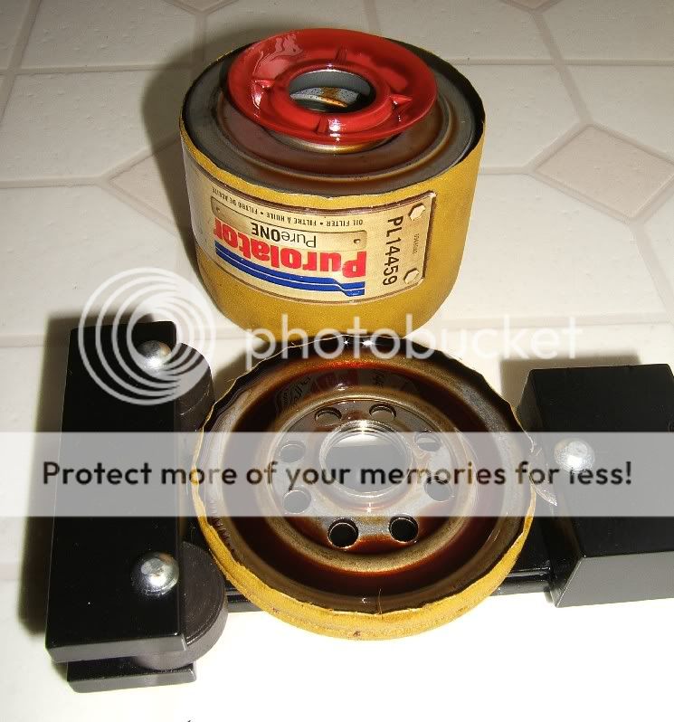

Initial cut open.

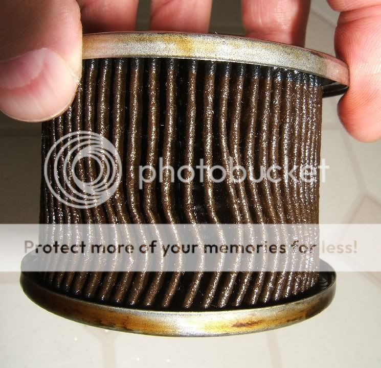

Media is a little wavy. Note - this car uses zero coolant.
Waviness is worse by the seam, but no signs of damaged media.

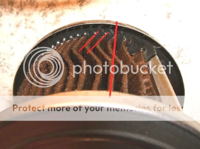

Where media is wavy, it looks like the base of the pleats were glued in crooked, and you can see by the red lines that the pleat runs are not aligned straight from end cap to end cap to begin with, so they were most likely wavy when new.

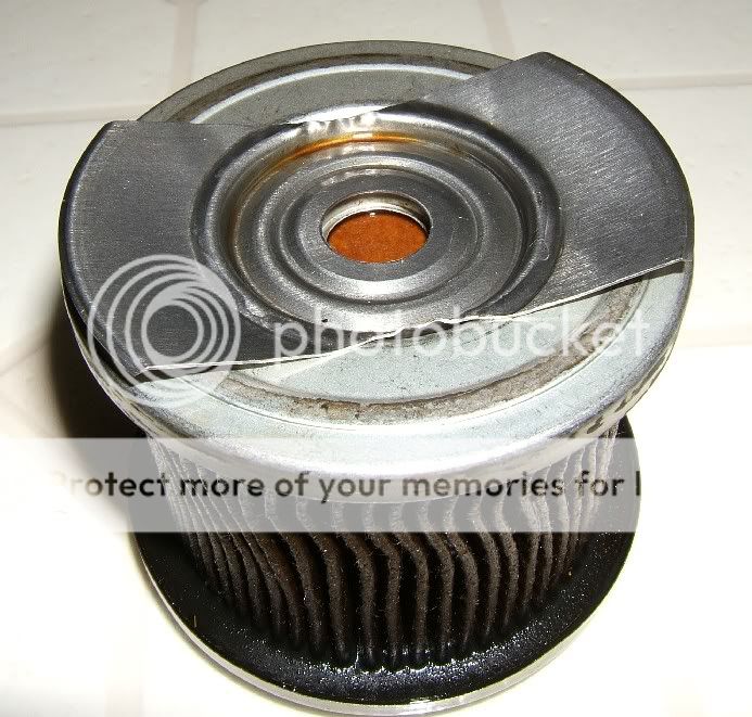

Leaf spring installed on top of media can. Leaf spring holds the guts tight inside the can.

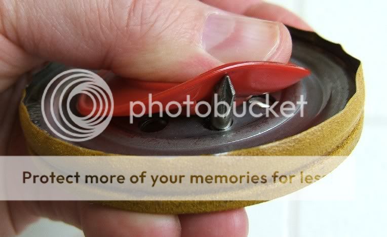

ADBV offset from its normal resting spot. Note the raised ring around the base that the lip of the ADBV seals up against.
ADBV in place and raised up. Note how the lip of the ADBV mates to the raised ring on the base.
Thanks for the pictures! No one has ever pointed out that the base plates do not exactly line up causing the waviness. Perhaps they are like that new?
