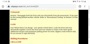

He already did. I guess I can take a picture for you.
Locking the front and rear driveshafts together at the transfer case has nothing to do with differential lockers (the switches for which are shown in 4WD's imagine of a Rubicon Wrangler).

The picture you posted says nothing about the ELSD staying locked. in fact the link posted earlier says it unlocks. You can see my confusion?
