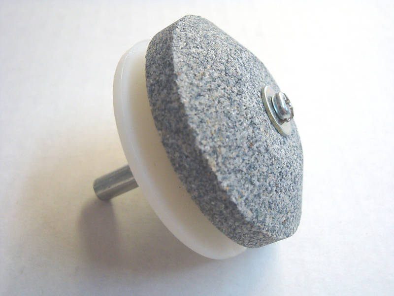

Does anybody have Dremel lawn mower sharpening attachment? If so, can you measure the gap on that adapter? Is it at least 1/8 inch? Half the reviews on Amazon say it is useless and half rave about it.
I use this cordless drill attachment I bought at Ace Hardware:
http://i.ebayimg.com/12/!B1OkS3gBGk~$(KGrHqIOKnEEw9CtuvE9BMdoyRPgn!~~_3.JPG
But apparently it doesn't do too good of a job, because whenever the TrueGreen guy comes around, he tells me to sharpen my blade again.
I think I'm going to have to try the old manual filing method...
