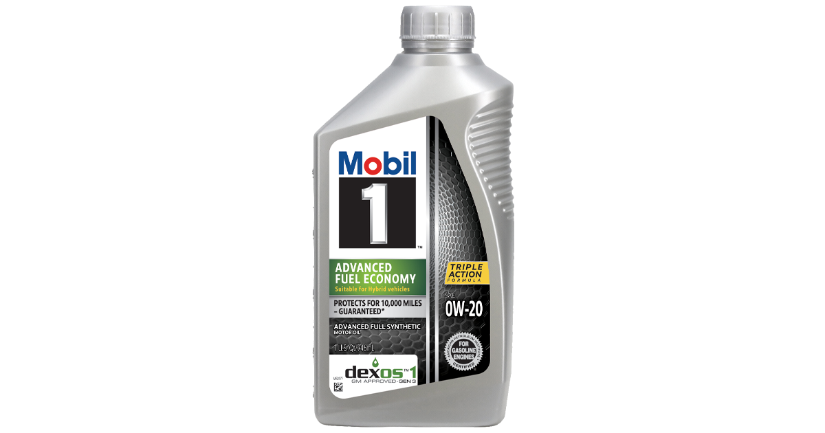

https://www.mobil.com/en/lubricants...s/our-products/products/mobil-1-esp-x2-0w-20/
https://www.mobil.com/en/lubricants/for-personal-vehicles/our-products/products/mobil-1-0w-20/
Location shows winters(Illinois? ). Since you keep your cars until the wheels fall off, maintain it and consider 5w30 for spring and the 0w20 for fall. And, looks like there is room for a bigger 7317 filter in place of the 6607. So, my other recommendation is to stick with a full synthetic media oil filter, changed at every interval, and use the oversized if it fits(simply verify).
I haven't seen a VOA, but the SDS from XOM says 60-70 PAO in the 0w20 EP.
Uh, so is that good? EP or ESP X2?
