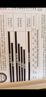

That is very good news indeed to hear ! My '17 Sonata DI loves producing soot, the oil starts to discolor relatively early in the new oil fill and burns upward of a quart of oil over a 4K Mile OCI . If nothing else , I'll be interested to learn if going to a 10W30 grade will reduce consumption as I am getting some blow by in an otherwise clean , well-maintained GDI engine . *I'd like to see what the 2.4L GDI owner's manual allows in other countries such as Australia , Europe , the Middle East , etc. to see if safe to run a 0W40 or 5W40 synthetic Euro oil ? I know some owners just go ahead and do it - I'd like to know if the engine design can in fact safely handle it in terms of oil gally size(s) , pumpability , engine tolerances , etc.
That's a picture of my 2015 owner's manual. I don't have a picture of it, but Hyundai issued a TSB on the Theta II engines ages ago. 5W20 was recommended in the 2.4 and 5W30 in the 2.0T for "efficiency" but as you can see, the owner's manual was pretty much self-explanatory. The TSB upped the recommendation to 5W30 in the 2.4 and 5W40 in the 2.0T. Whether that TSB was being followed is another matter.
Try replacing the pcv valve, doing an intake service, then changing to 5 or 10W30.
