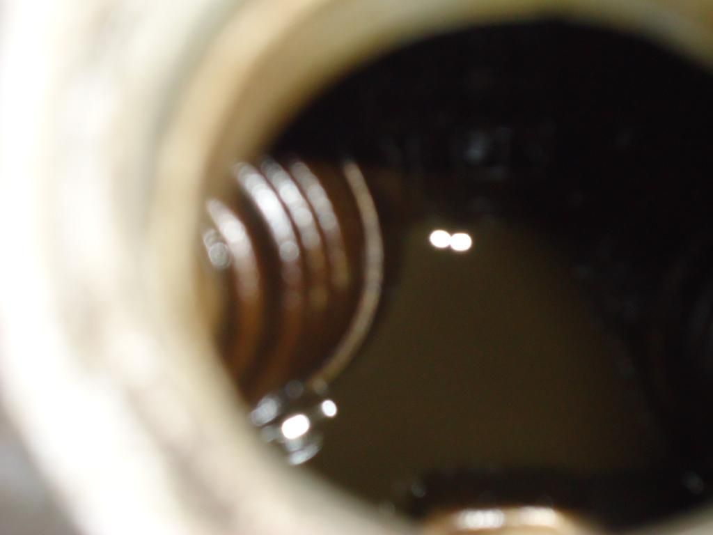

Here's an update: I ran the Kreen for 1,000 miles, the slight lifter tick gone. Down the fill hole is an improvement, however not good enough to show up on the pictures. I'm 2000 miles into the fresh oil and will add another pint of Kreen 1000 miles before I drop the oil again. I will try and get pictures up soon.
Thanks for hanging with it!
This pic is about 2,350 miles after the Kreen mixed oil was changed. The oil is actually pretty clean on the stick and on a rag. The valve springs that are visible are cleaning up slowly.
This is about the best I can do quality wise.

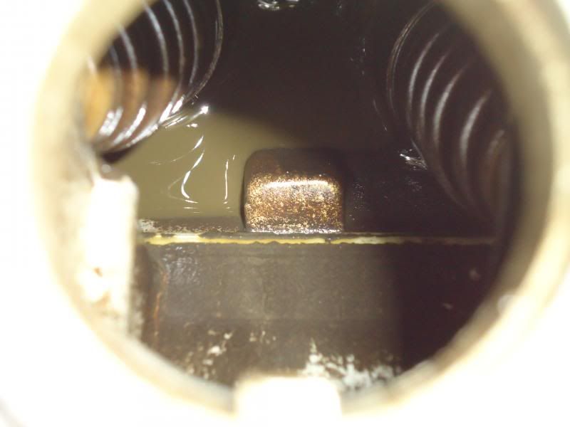

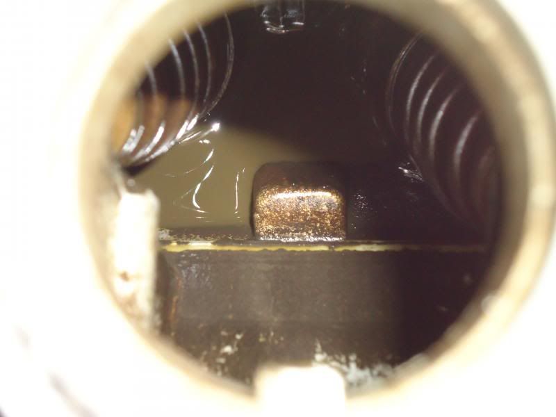

Nothing additional to report. I'm due for an oil change in a few weeks, the improvement is slow and steady, not worth taking any additional pictures at this point. It's about the same as the pictures I posted 12/23.
Here's a fresh set of pictures, I haven't been driving that much but that's going to be changing soon.
Here's what's been done and the miles: at the oil and filter was changed at 85,815 at 88,500 miles a pint of Kreen was added. At 89,494 miles I added another 8 ounces. The oil was changed at 90,491. There is about 1,500 miles on the oil and it is clean. For some reason the pictures make it look dirty.

I'm taking a conservative approach. I added a pint for the last 1,000 miles of the OCI for the first run. For the second run I'll round off the numbers, I added a pint ran it for about 1,000 miles then added another 8 ounces and ran that about another 1,000 miles. The total OCI was just under 5,000 miles, the Kreen was in for about 2,000 miles of that interval.
I don't remember how much I added to the gas. Depending on tank size you can add up to a pint to a tank of gas.

As I mentioned in the beginning I had a slight tick which was eliminated in no time flat after Kreen was added and has not returned.
The current fill is untreated, any treatments were done toward the end of the OCI, so in reality I'm really not following their directions. I have no plans on adding any more Kreen, if I do I would wait until the winter. The oil is much cleaner now than it would normally be after a Kreen treatment, but there is still some cleaning going on.
That little engine runs great, in all fairness though I tuned it up so I can't give any credit to Kreen for improving how it runs. The original plugs and wires were in the car for 86,776 miles, they weren't that bad but certainly were due for a change.
I have a feeling that Kreen did a pretty good job attacking that garbage, and oil alone will do some additional cleaning. When the weather gets cold again I might give MMO a shot, continue with Kreen, or try synthetic oil in it. Synthetic oil is something that was never used in that engine.
