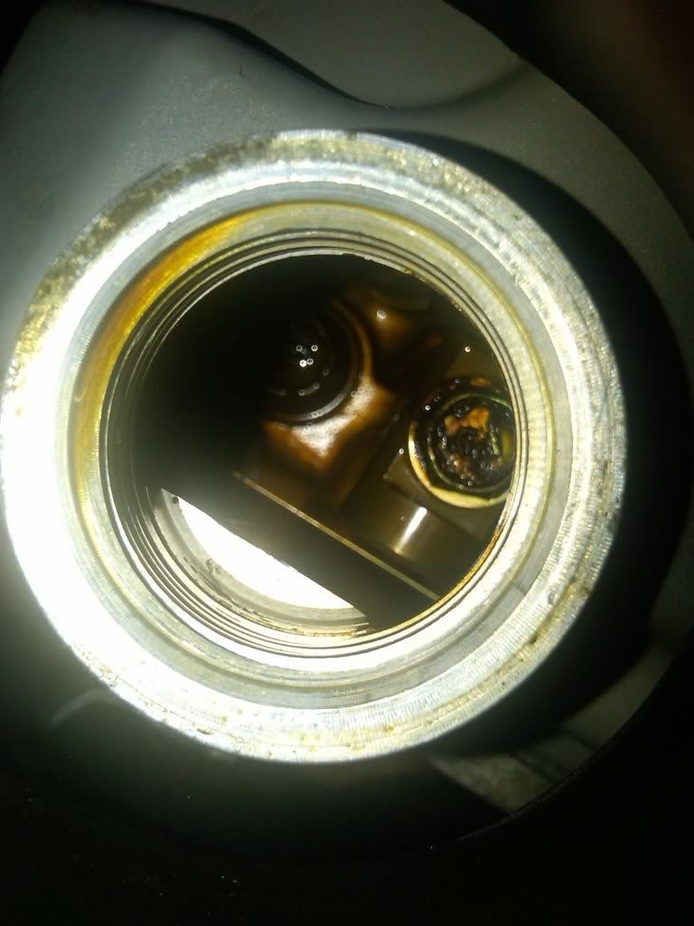

Picture I promised. Like I said, not too bad. This was prior to the last change (I ended up taking pictures to use to see if what I was doing was making any difference).
Like I said, it's yellow everywhere, but I don't think it's bad. I just want it silver.

Well, the picture upload / link process isn't working for me. This might work...
http://s1111.photobucket.com/albums/h474/bettythe/?action=view&current=P1030577.jpg
If that link doesn't work and you still would like to see the picture, PM me your email and I will send it...
i think kreen will make short work of it. be sure to get some after pics!!
it actually looks like what ever varnish you had is starting to get soft and dissipate. the syn you have been running is doing its job...
you should try and take your pics in the same position that way its easy to reference
one thing about it, you can see some sludge formation on that bolt head....
Yeah, sorry. The first set was with our Camera, the second was with my Cell phone. Sorry about the difference in angle. That was the best I coud get with my Cell's light.
The Edge has not stopped it and will be changed just as soon as the Kreen shows up. Ugh.
The bolt with the sludge on it was on the top of the first pict (but was clean then).
bob are you sure it was clean or was the whole top of the bolt black and now just starting to clean up and show the gold underneath? hard to tell from the pics becuase its not well lit in the 1st one, and it really just does not make sense! you shouldnt be forming more varnish and sludge with good oil and short ocis

It's hard to say. I would think I would have noticed. This pict is from the first run of photo's as well. It sheds a little more light on the top bolt.
bettythe
From the others i have seen it doesn't look anywhere near as bad as they did. You may have nipped this one in the bud.
I think Kreen will clean it up nicely.
It doesn't look bad, but in my car, right side, near oil fill hole looked 4 times better than left side near oil return hole,which was all sludged up. So consider worst case scenario, I would use couple short runs on dino with quart of MMO(like 1000 miles), then 2 short runs on Kreen, and piston soak if possible, change pcv valve, clean plugs(during piston soak), and than continue using of MMO for future full time ocis, and forget about it. MMO is like 3$-$4 at walmart, so not a big deal to add it every OCI, and to gas tank.
As I know in Europe, engine flush is done before every oil change,by lots of people, by flush oil(thin oil) or chemicals. Maybe that's why there is more 20,30 year old cars on the roads?
Save for those questionable deposits on the bolt head, the color looks just like mine. A slight gold tinge, but really, nothing out of the ordinary for the miles. I personally would stick with quality synthetic oil without any solvent adds, but will defer to those with more experience for that recommendation.
