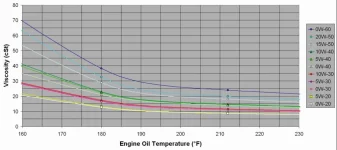

This graph starts at 160f. And it will always be lower viscosity than a 5w. Which means it will flow faster and provide better lubrication.
I could special paper all of them. But it’s really pointless for pcmo with short oil change intervals. 0w20 will be fine and have better cold flow over a 5w20.

The viscosity difference between 50f and 150f is fairly significant for any grade of oil, so the minute differences in viscosity between a 0W-xx and 5W-xx of the same grade (during warm up) doesn't support your theory of reduced wear.
It’s not a theory. There are tons of engine sequence tests done that prove lower viscosity oils on start up, reduces engine wear.
Either way, it’s still a much better argument than splitting hairs over viscosity improvers in an additive package.

Flow faster?
