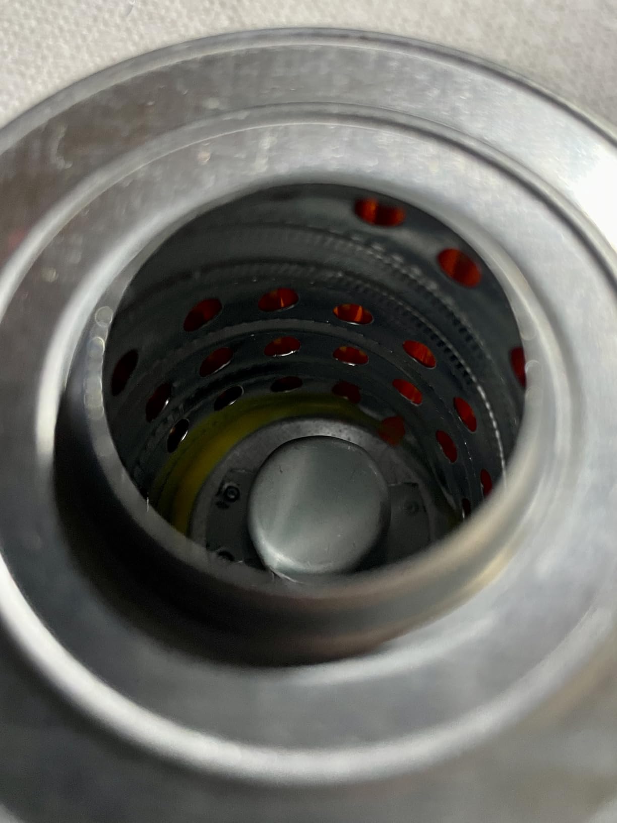

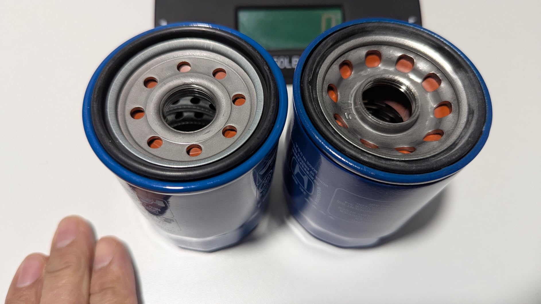

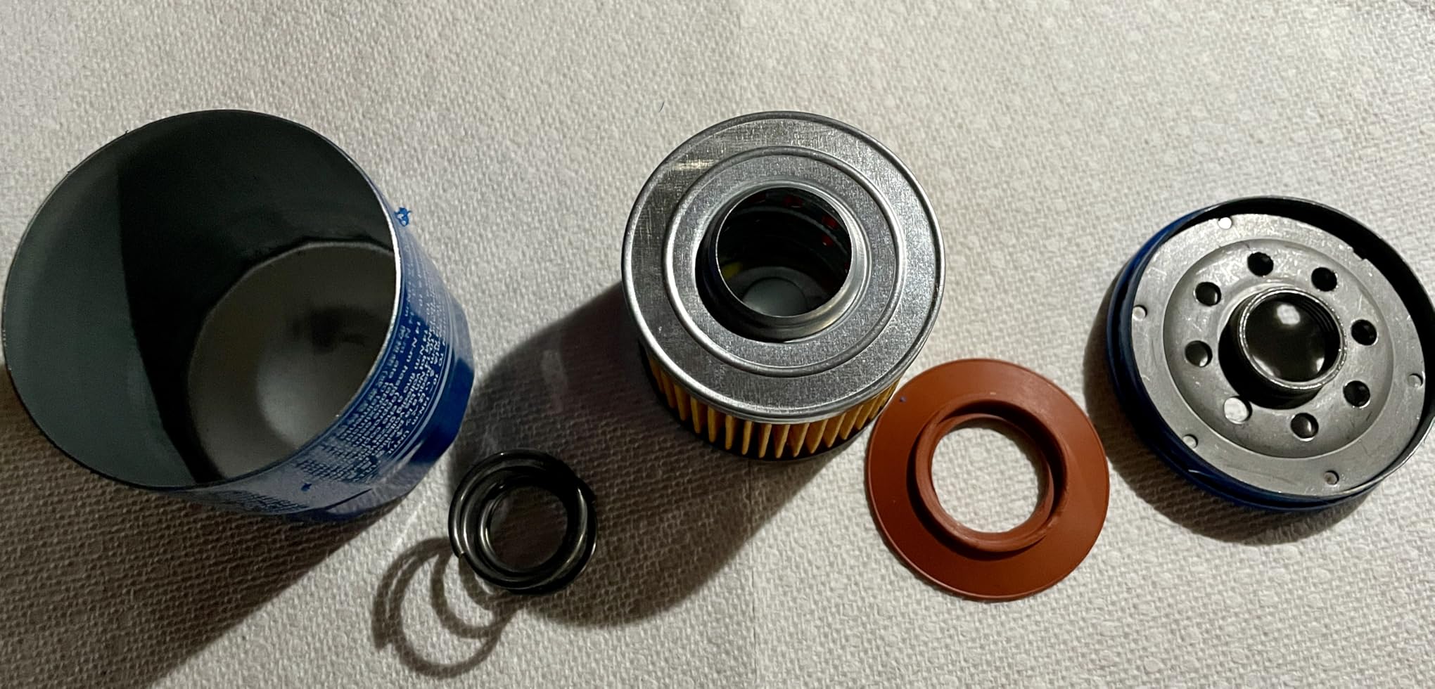

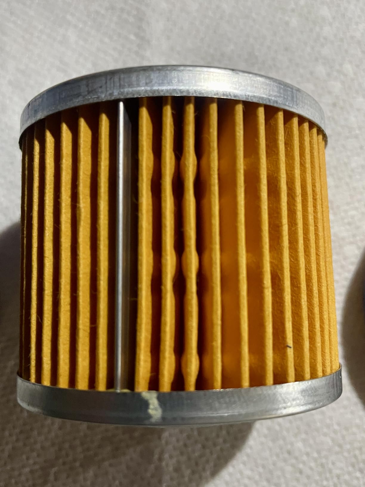

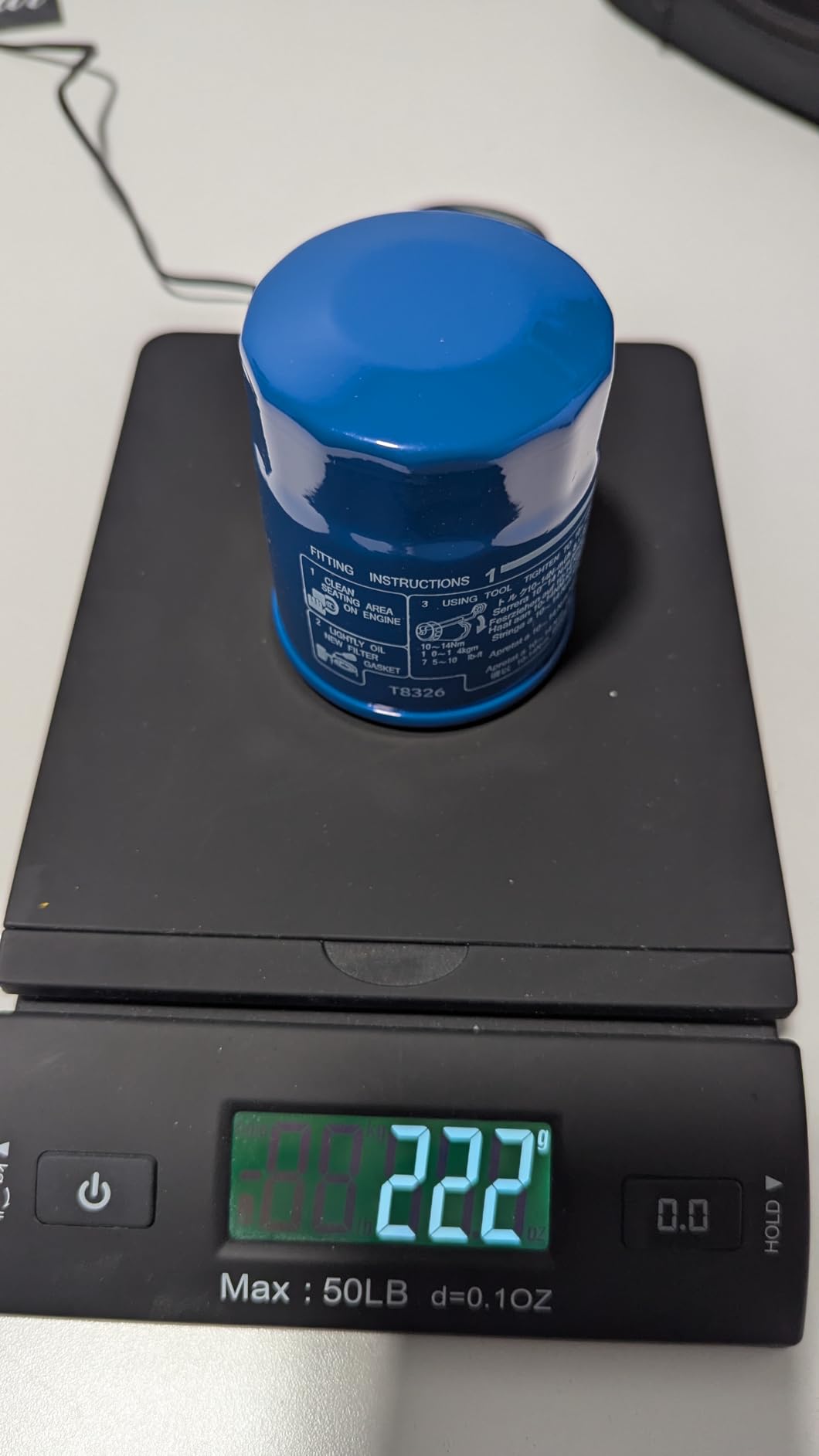

Here is a Kefly Honda cut open . This guy was commenting they are heavier than his OE Honda filter.... they look like possibly from one of the PG associated factories.
Certainly do like typical PG type of design and construction.
