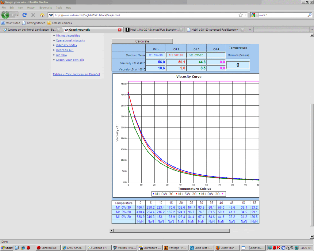

Fallguy, I'm running a thinner oil (5W-20) than recommended (5w30) because of how I use my vehicle. Because I have a short commute, my oil temps hardly ever get up to normal temperature (100°C). Because of this, I want my oil viscosity to be as low as possible between 20°C and 60°C, yet still be just thick enough to protect when the oil does get up to normal temperature (long vacation trips, etc). used oil analysis so far show that this lower viscosity use is doing OK in my application (no excessive wear caused by inadequate viscosity at full temp).
The widman calculator graph shows the low temp viscosity difference between 0W-20 and 0w30 oils. Notice that the 5W-20 oil (thrown in for comparison) is slightly lower in viscosity at the temps I'm most interested in than is the 0w30 oil.
