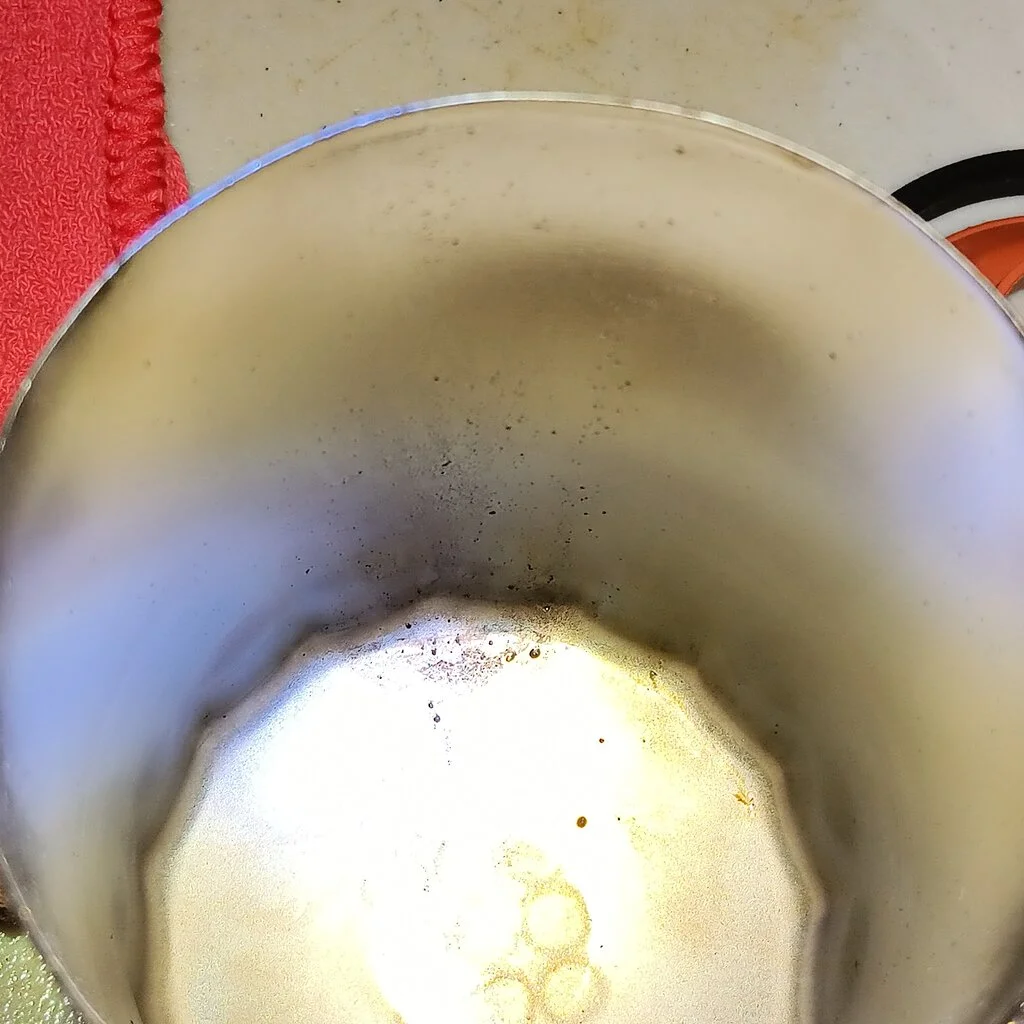

I thought of doing that at some point to accelerate cleaning the baffle plate and fill port area on my 1NZ-FE. The amount of varnish removal is super slow because its deposits formed from oil vapors by previous oils of many years and that it has pretty much no active oil flow as well in that region. Good to know its safe to do that combination fill of HPL oil and EC.Good news - I verified that yes - using the HPL Engine Cleaner at 20% volume with our PC Engine Oils is okay and will boost the cleaning without effecting the seals - albeit at a slightly higher cost than using other oils.
The varnish is easily wiped off with a finger near the fill cap thread neck to reveal bare metal but still has a bit of layering to it last time I inspected my oil fill port. Betting more on time and patience to see it through than accelerating it.

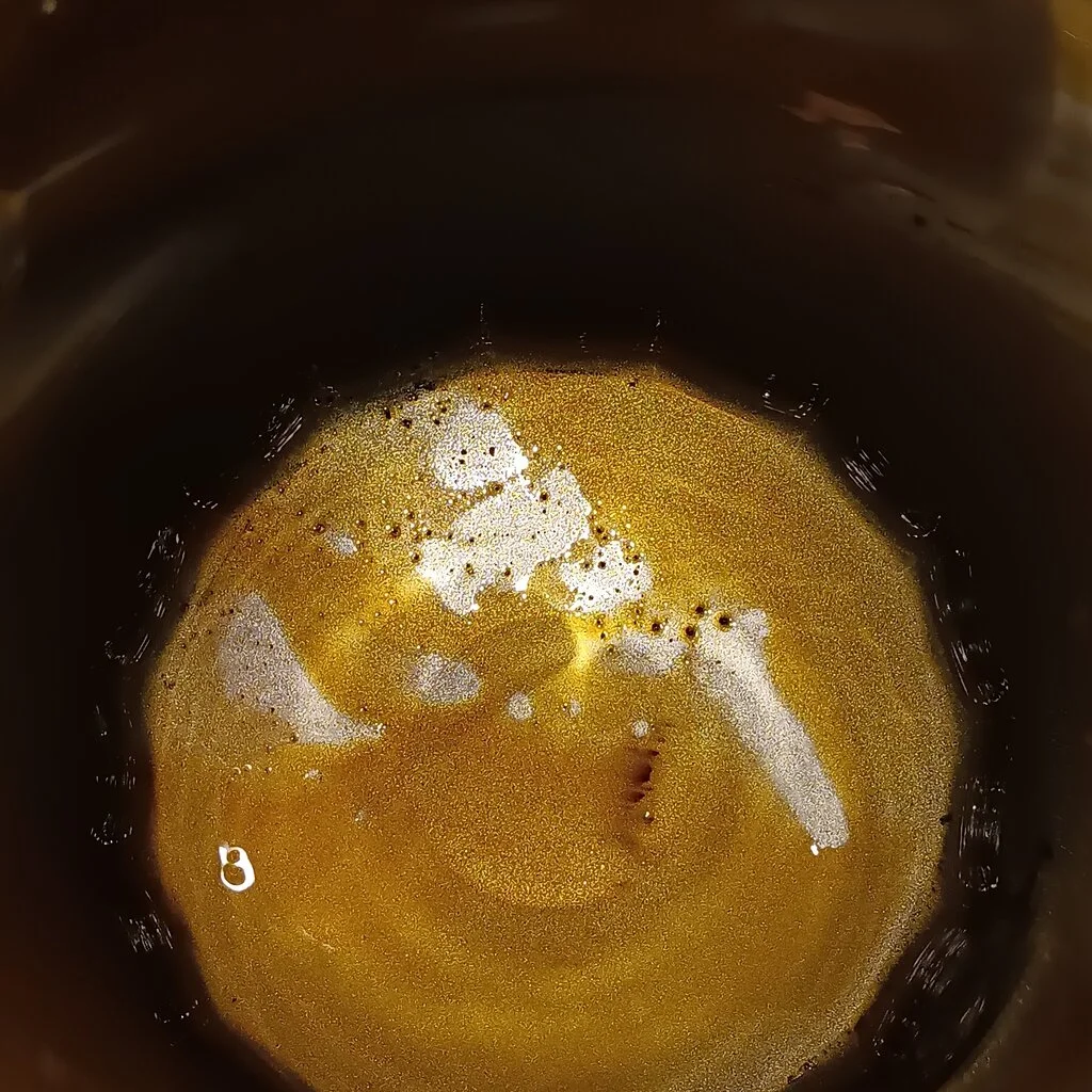

Looking good!I did 2 rounds of EC30 in my daughters CRV. Currently 1200 miles on this OCI with a frankenbrew but one is HPL PCMO 5w30. 1.5qts Pennzoil Platinum 5w30, 2.5 qts Pennzoil Platinum Euro L 5w30 and 1qt HPL PCMO 5w30, XG7317. I'm ok with how this looks for being clean since CRV has almost 234k on it. As '53 Stude said, both clean.
Then through the oil cap before EC30 started and 3 days ago with the frankenbrew. Slow and steady works for me.
