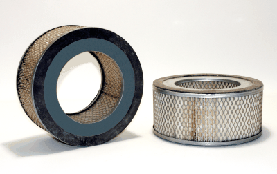

Those are all 14" I have an 11" K & N
If you have room for a 14", the top few ones are an entire kit, include the base, filter and lid.Those are all 14" I have an 11" K & N
I have a 60° V6, so a 14" just looks kind of ridiculous. Wondering how I could find an 11" paper equivalent to my K&NIf you have room for a 14", the top few ones are an entire kit, include the base, filter and lid.
https://www.wixfilters.com/Lookup/FilterBySize.aspx?catid=1&styleid=1I have a 60° V6, so a 14" just looks kind of ridiculous. Wondering how I could find an 11" paper equivalent to my K&N
That is very helpful. Found a couple good choices. Hilariously, one is the OE filter for my car which hasn't had a stock air cleaner in the 21 years I have owned it, so who knew. lolhttps://www.wixfilters.com/Lookup/FilterBySize.aspx?catid=1&styleid=1
Wix has a lookup tool. So, for example, the 42912 is 10.25" across, 2" tall. The 46369 is 11" across, 5" tall:
Quite a few options, I don't know the height of your existing filter, but you could go through there and see if you can find a match.
