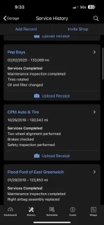

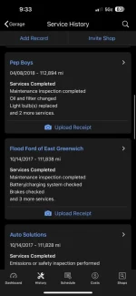

It was recently serviced at Ford dealers in Cranston, RI and East Greenwich, RI
Check front and rear subframes for rust, same with rockers
Your prospect is a Gen 1, with the 2.3 Duratec, and the Mazda derived FNR5 5AT
If it's not too rusty and worn, it'll make a decent first car
MY07 has side airbags standard, good for safety 🦺
It will need this that and the other thing, but parts are fairly cheap and they seem easy enough to work on
If it hasn't had a throttle body and a purge valve, set aside a $100 bill for those, easy to swap
