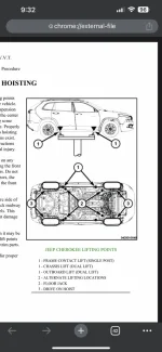

The reason for my post. Position 1 is the pinch welds. Because of the plastic rocker panel moldings, there is not enough room for a larger 3 ton floor jack or the rubber pinch weld adapters that fit that cup. So I need some thing that is narrow or rectangular, not round like a hockey puck. Position 2 is blocked by plastic undercarriage covers in the back so I’ve been using the rear aluminum control arms. Would rather not. Removing the covers is doable, but not something that can happen in five minutes. I can’t use the crossmembers or rear differential on these vehicles.

Most VW have a hole in the frame that have a jack pad made to insert into them.
I do have holes like that. Going to get my calipers and see how large they are. They are position 2. Almost like the body was on a rotisserie at some point.
First look at how the factory jack lifts around/by the pinch welds. Duplicate that.
On my Subaru Forester and Crosstrek the factory jack lifted the frame on the inner and outer side of the pinch weld. The factory jack was designed so no weight was on the pinch weld itself but on either side of it. The pinch weld just held the jack in the proper place so it did not move/slide in or out.
I "think" they are the factory holes for holding the body during assembly. It must be the German way. I toured the SC BMW SUV factory last year and they had 4 prongs that the body sat on for all the assembly, at least up to the point the suspensions and powertrain were installed, then they had a different vertical prong that held the car up to the end of the line and wheels were installed, a few stations short of roll out. The first "prongs" allowed the car to attach to a rotisserie for various interior, fuel lines, wiring harness etc once all the light weight things were attached the body went to suspension.
