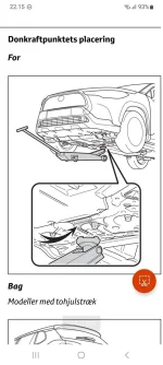

I haven't noticed if the engine is mounted on the subframe. But it does have a lifting point marked in the users manual.
