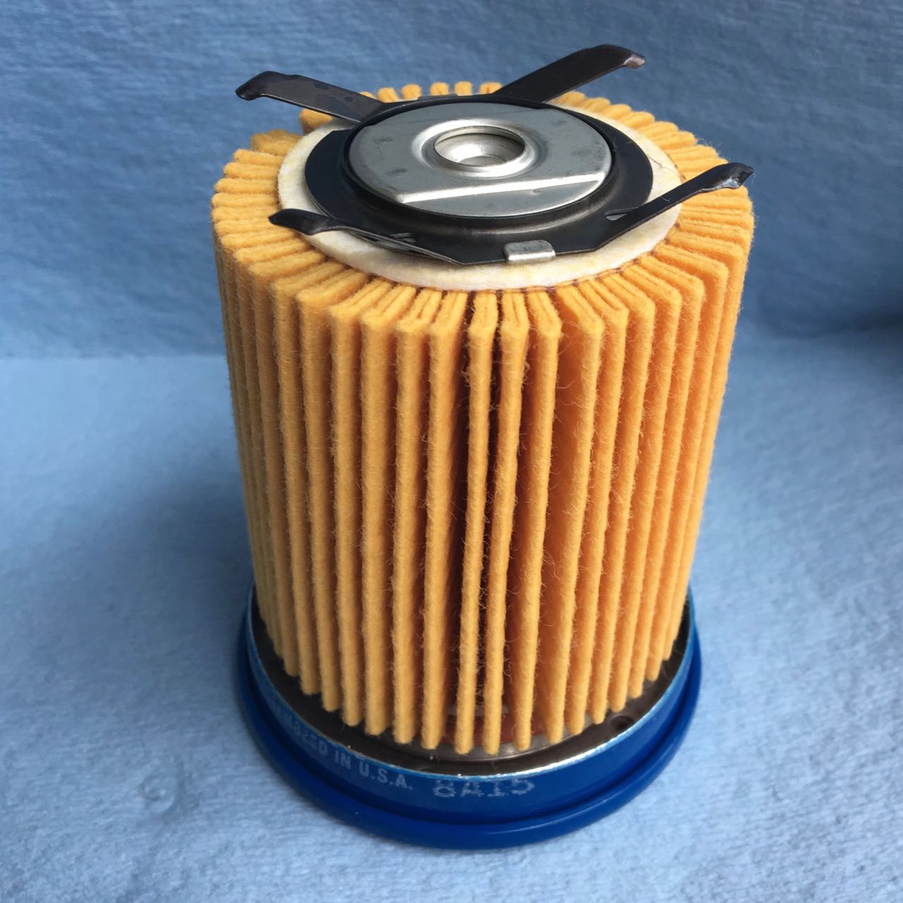

I received these filters last week from Metfanant.
I weighed his 5, one of mine and a HAMP.
All of his were 211g-213g, my A01 was 211 and the HAMP was 214
I cut one open and believe it is genuine.
The diamond with the dots is a visual indicator of which stamping line the cap was stamped on. Different number of dots represent a specific stamping machine.
This is done in case of quality issues, they can track which filters are affected (if assembled) and which cap it is (prior to final assembly)

My last two remaining genuine Filtech 15400-PLM-A01 shows four precise dots (spot welds?) around the round part of the spring pressure relief
at the inner bottom of the filter. I volume purchased 40 of these at about $3.50 each 14 years ago.
Some recent (FAKE?) 15400-PLM-A01's appearing on eBay and Amazon show four small screws instead. Now why would screws be
located inside an oil filter downstream (past) the filter medium? This is a recipe for disaster in case screws come loose and manage to
enter the engine.
Also, one may find yellow (plastic? filler to perhaps anchor fake spring pressure relief base and screws) material at the bottom of the oil filter. The protruding circular part
protruding up from inside the bottom of the FAKE? oil filter is also smaller to accommodate the four screws and may actually be off center when looking
down the filter opening.
